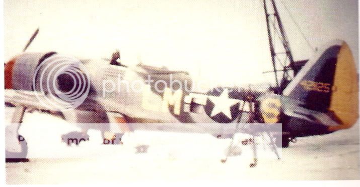

Hi Paul.
Thats a colourised version of this photo.
Dont rely on it for any colour references whatsoever.did you find it on the WW2 in colour site?
Regarding the chipping.
Ive read that some gear struts were painted olive drab.( no idea why,,anybody?? )
What appears to have happened in the photo of Bob Johnson earlier in the thread is that the olive drab paint has worn away exposing the metal strut.
Yes, you probably are thinking way to deep on this one.

Yes WW II in color site it was..
