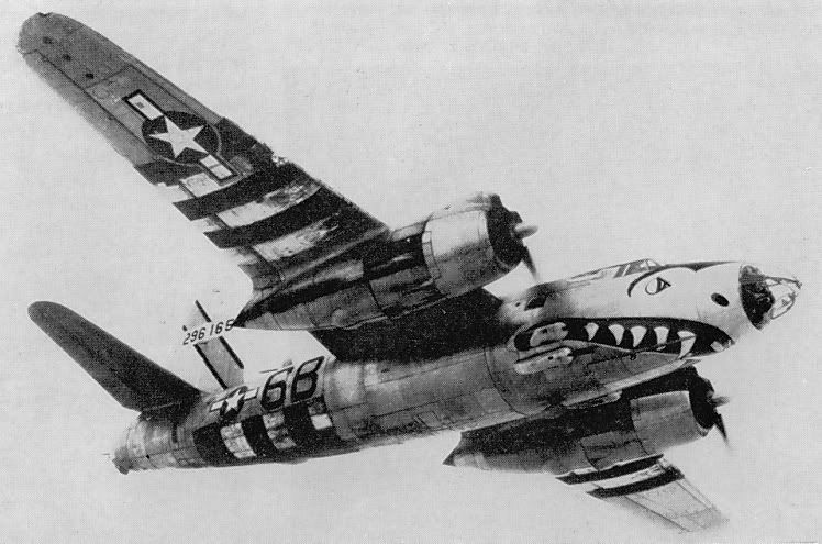

Well, I thought my source was Jerry Scutts "B-26 Marauder Units of the Eight and Ninth Air Forces". But I'm not able to tie it to any page of that book this AM.
There are several photos in the book of B-26's with "borders" around the stripes and several of the color plates show OD bands on NMF planes that are wider than the stripes. AMT produced markings for Big Hairy Bird 6B-T SN 42-96165(?) that match the 6 stripe pattern shown in a color plate and a B&W photo in the text.
I don't think those bands got there by accident, and there would have been very little time to apply and dry a primer before applying the stripes to thousands of aircraft. There must have been an order.

Big Hairy Bird with what looks like 6 stripes (in B&W)

References Ive found to the B-26 shown in the photo refer to the "non regulation" invasion stripes. Actually, you get some very interesting results on Google if you just search for "Big Hairy Bird" without a B-26 prefix,,!?!?
Non regulation is fine, in the same way as Gabreski's aircraft had the black sections of the upper fusalage stripes removed was non regulation. Naturally, there was no "order" issued for the removal of these upper black bands.
As far as 8th Fighter Command, and indeed all of the units flying on D-Day goes, there is no evidence of any order regarding "priming" aircraft that I have found, or indeed ever heard of until a couple of posts ago.
The extra stripes on B-26's ( one at least anyway), is certainly worthy of further discussion. However, thats a subject for the general Aeroscale forum and not the P-47 SIG.

Nice picture,corrected I stand! (It's a fair cop,I'll come peacefully,no need for the handcuffs)
Thanks for showing.
Steve
Edit:
Good excuse to show a nice picture of a standard set supposedly on D-Day. There is plenty of shipping below. Not a rebuttal,just a nice picture.
Steve

I can't prove the order exists, so I concede Nigel's point that it was unauthorized. But I remain hopeful that it might show up. Since I've seen several B&W photos of NMF B-26's with borders or odd number I assume it was a common practice.
My point to the original poster remains. The stripes were applied in a hurry, in inclement weather by inventive crews who probably didn't follow every order to the letter. The last thing on their minds was how armchair historians would interpret their work 66 years later.
