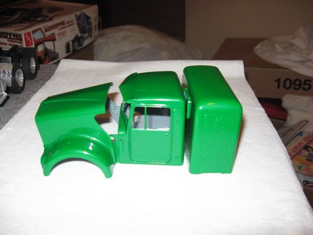

Bob what kind of paint did you use on this so i can get right kind of clear coat for it after i put decals on it.
old-dragon
Member Since: August 30, 2005
entire network: 3,289 Posts
KitMaker Network: 592 Posts
Posted: Tuesday, November 01, 2011 - 09:24 AM UTC
Hmmm, that was ahwile ago...I'd have to guess it to be Testors bright green pearl - enamel. You can coat lacquer over enamel, not enamel over lacquer, so the testors clear coat lacquer will do you fine.
