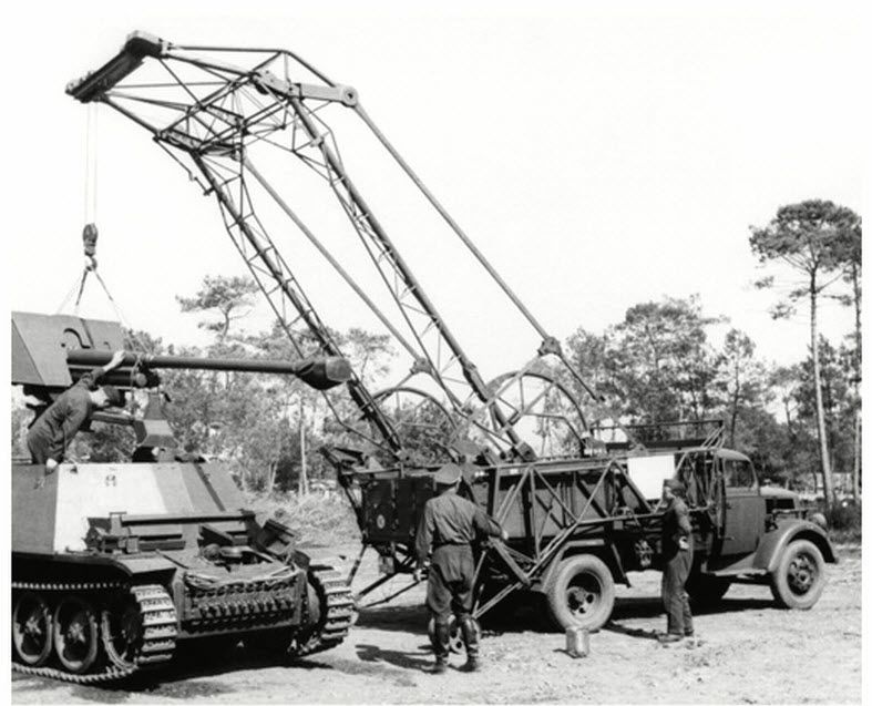

AND THE WINNER IS:
for the most unusual conversion of an Opel Blitz!

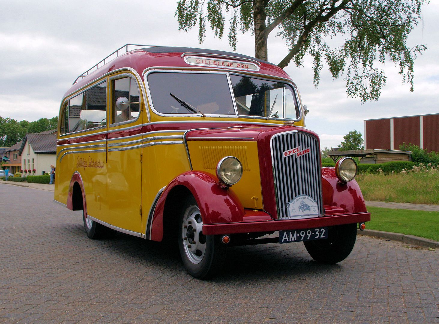

Super sharp Blitz 2.6 Bus:

The wrecker conversion, it looks like they used a radio cable reels as the 'landing gear' stability wheels on the back.
And Tamiya has a 1.5 short bed coming out now I believe.
That exact same thought crossed my mind about using cable reels but I wondered if they could carry the load? Also the thin metal rims would just cut into the ground wouldn't they?

If they welded some metal stock around it I bet they could lift two, maybe even three tons before things go wrong. It's hard to tell with all the odd shadows on that guys pant leg being directly in front of it.
It looks way to big to be a normal landing gear type wheel. And just with a quick look there's enough room for six holes, which I think is how many there on a reel.
Couldn't find a picture of the specific type though. I'll poke through my reference sites.

Found them, thrid photo down.
Not one of my references, figures. Not even looking for the damn things and get them in a unrelated search.
EDIT: Failed to post the link;
http://forum.axishistory.com/viewtopic.php?f=47&t=73232&start=135

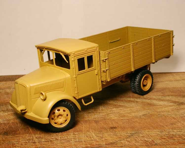

Posted: Saturday, April 12, 2014 - 04:25 PM UTC
Kudos to Italeri for making so many variations on the Opel Blitz theme!
(Unlike some other manufactures that make one and then they're done!)
Einheits cab Blitz under construction:

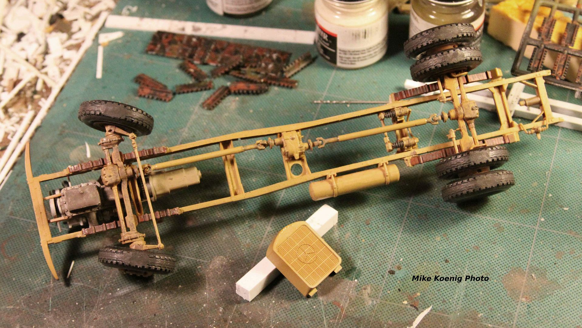

Posted: Tuesday, April 22, 2014 - 12:38 AM UTC

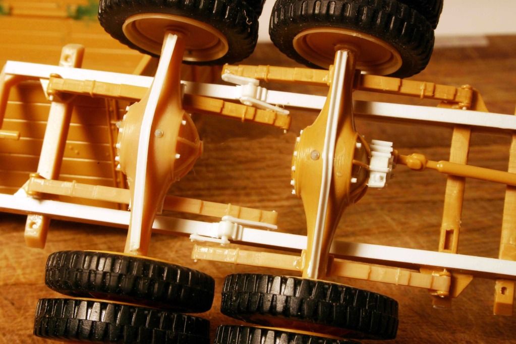

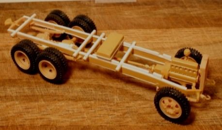

I know this is bogus but I had the idea and just could not help myself.
The Russians did add a third, unpowered axle to some captured Opels to increase their load capacity but to my knowledge Opel never experimented with a three axle Blitz. (Can't imagine why not!)
As far as the rear suspension goes I figured any attempt to build a one of a kind, experimental 4x6 Blitz would use as many off the shelf parts as possible which is why I avoided the temptation to do a custom leaf spring arrangement in the rear.
I used four stock Blitz leaf springs and overlapped them using a teeter-totter equilizing arrangement between the the two sets.
In this photo the connecting driveshaft between the rear axles has not yet been installed.
(More photos to follow.)

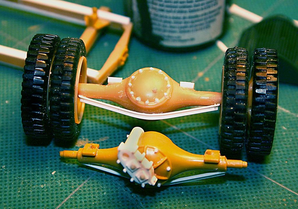

Posted: Tuesday, April 22, 2014 - 01:00 AM UTC
This structure is called an "over the shoulder gearbox". Use of this device avoids the need to add a transfer case and double rear drive shafts to the vehicle such as is used on the US Deuce and a Half.

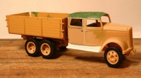

Posted: Tuesday, April 22, 2014 - 01:17 AM UTC
I considered going with a standard cab and an extended load box but then thought what the heck, if Opel were going to show this design to Hitler they would have gone for the most striking design changes possible so why not a crew cab as well?
I made the body overhang at the rear the same as it is on the two axle Blitz. If I were to do it over again I would move the 2 axle boggie closer to the rear of the vehicle.

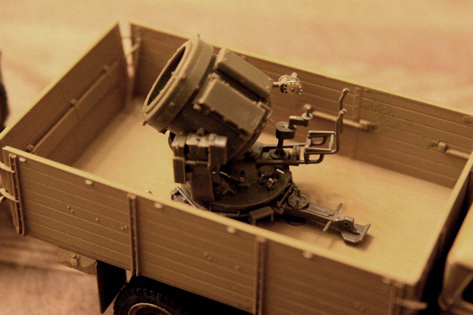

Posted: Tuesday, April 11, 2017 - 01:21 PM UTC

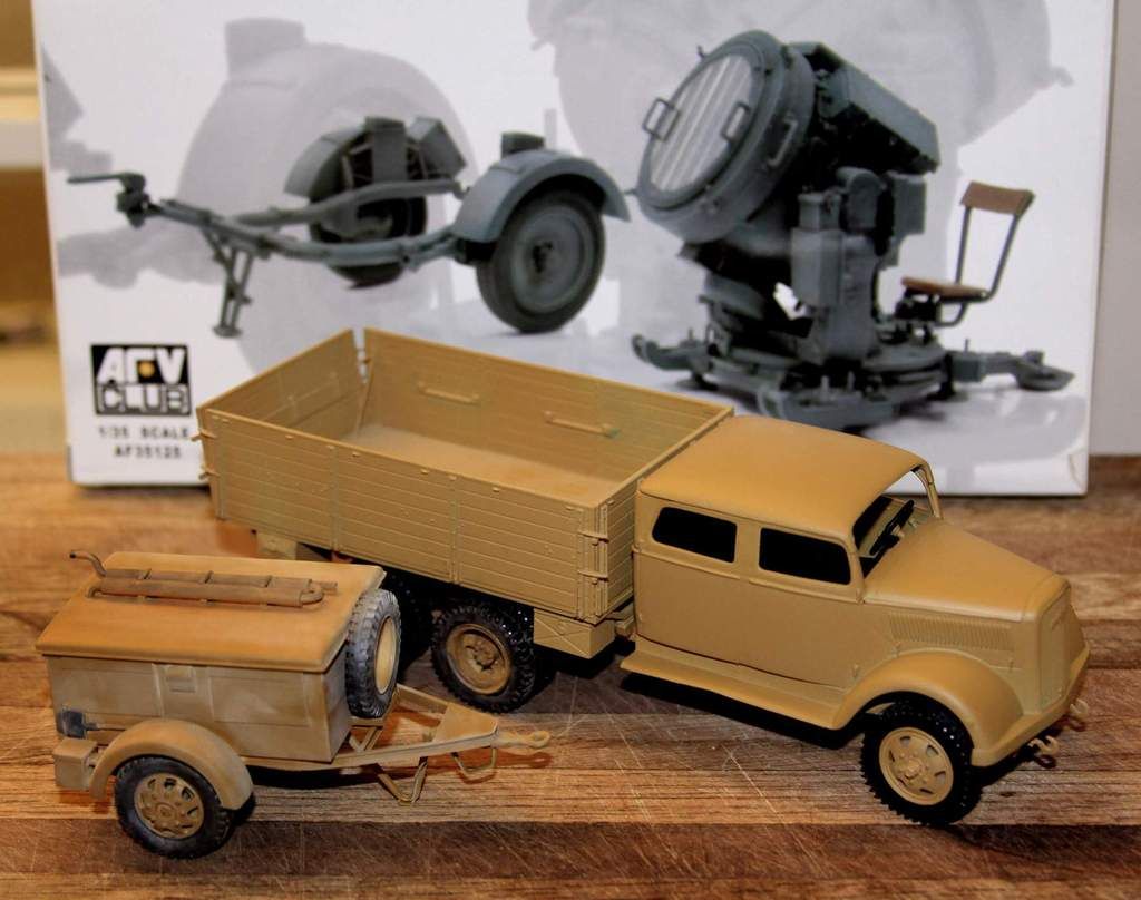

Some progress on my kooky 4x6 Blitz searchlight truck and generator trailer:
I intend to also add a large wooden, slope topped tool chest at the front of the loadbox and electrical cable reels mounted at the rear edge of the bed.

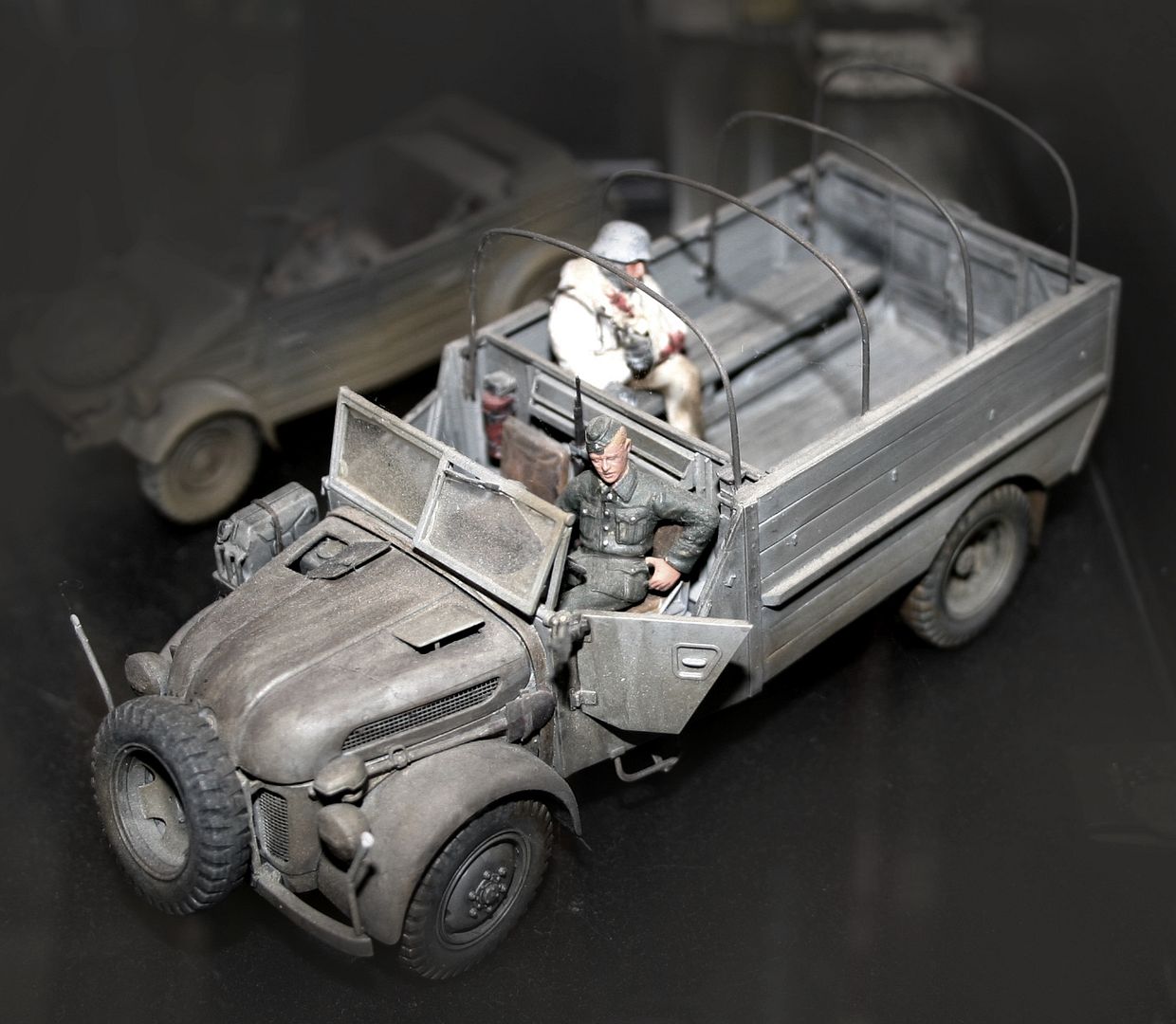

A Steyr with length wise troop seats: I built this model based on a Wings and Wheels book that has photo documentation of the real vehicle.

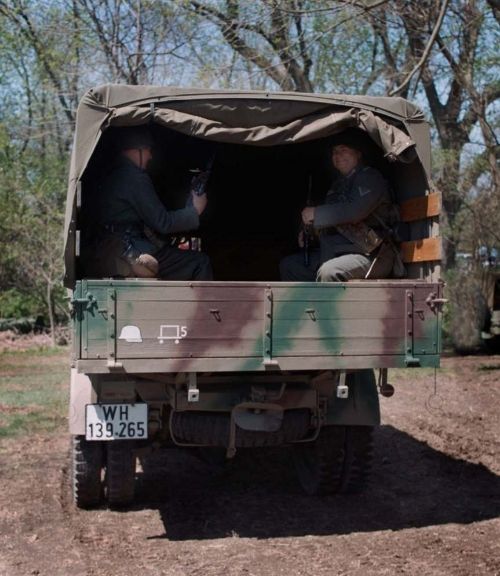

Then too, here is also a Blitz with length wise seating:

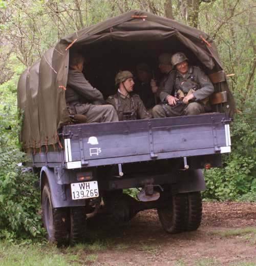

And another, different Blitz also with lengthwise seating,

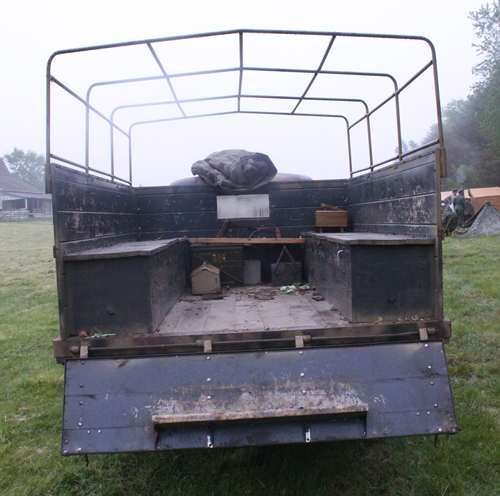

And finally, a Ford 1500 with lengthwise, toolbox seating.
