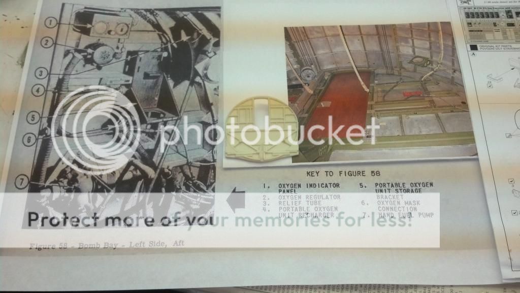

PLAN OF ATTACK
Posting has been sparse as I suffered an "inspirational lapse" after finishing the forward bulkhead of the bomb bay. Call it a case of the early-mid build blues: Will I EVER get this damn thing done?
Anyway, I am just about over it. I will be starting with the left after bomb-bay as pictured below: some little seen details from the B-17 pilot's manual, and where they go on the kit part:
I actually think it will look pretty neat when done. Will add a portable oxygen bottle to the bracket, and I do have the hardware from Eduard brass spares (mostly). Before starting, however, I have to remove the molded in resin radios, etc. on the other side of the bulkhead in order to fix the Eduard details there later. Don't want to do detail work on one side and THEN undertake major surgery on the other.

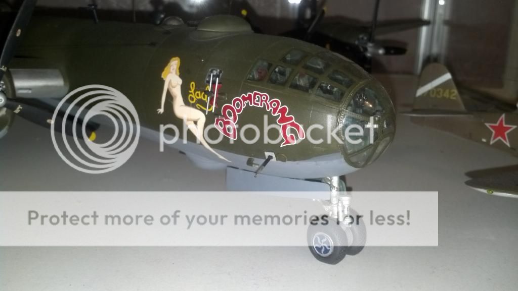

Someone asked me to post some pics of my 1/48 B-29. Here are a couple of non-professional shots.
FYI, yes that really is the hideous MPM P-63 1/48 kit in the foreground, but NO I did not do it (except for the cockpit). A friend who is a pro did it. Amazing work on his part. That kit is horrible.
I was very happy with how this early OD/NG B-29 came out. It took about 4 years, on and off, to complete. Do note the engine instruments visible on the flight engineer's panel as seen through the window just above the word "Lady."
