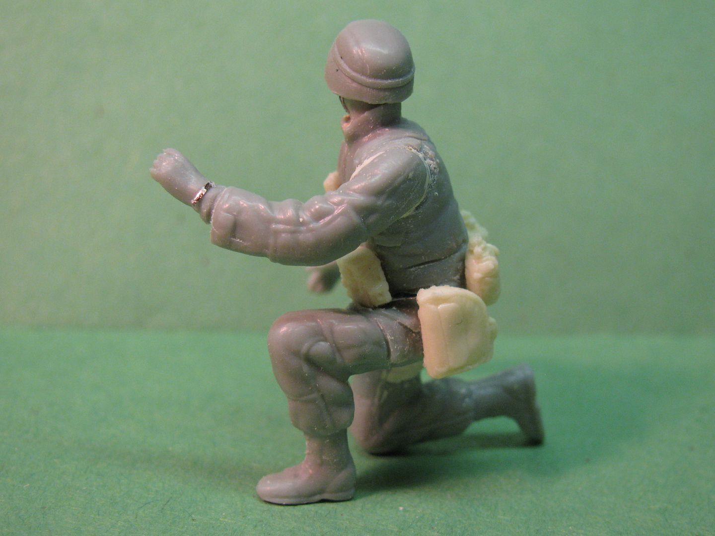

Nick,the course I usually follow is with the plastic figs and then resin heads. A good example is this. The body is from the Dragon kit and the head is Hornet.
This is my usual practice of posting in progress pics of the little dudes so I can see better on the 'puter screen what still needs work and the rest.....if it ain't broke,don't fix it.
First up,the gunner. I purposely put his helmet tilted back a bit because a tow gunner has to do that to fit into the sight.
I cast some resin parts I liked the best from my recent para build. They are former Tamiya bits as the ones in the dragon kit were way too big and soft on detail. I still want to work on his gloves a bit. Needs filling out. Otherwise,what say ye?
Remember he is wearing a flak vest so may seem kind of"chunky" or....maybe he just looks like me!! LOL

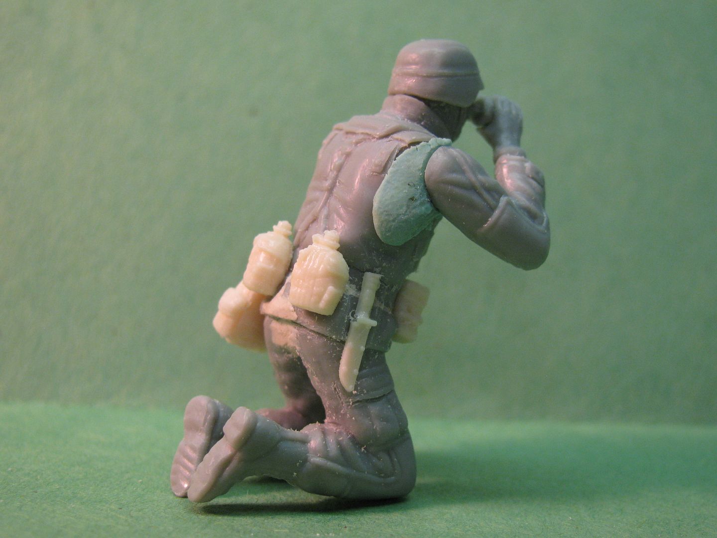

Number two guy up after putty and LCE added. Needs some work but this gets me to where I can see the flaws better. He will have an M16. The gunners' personal weapon was a Beretta M9
And yes,I did make the pro mask stick out like that was they did that in this position. They are not that heavy.

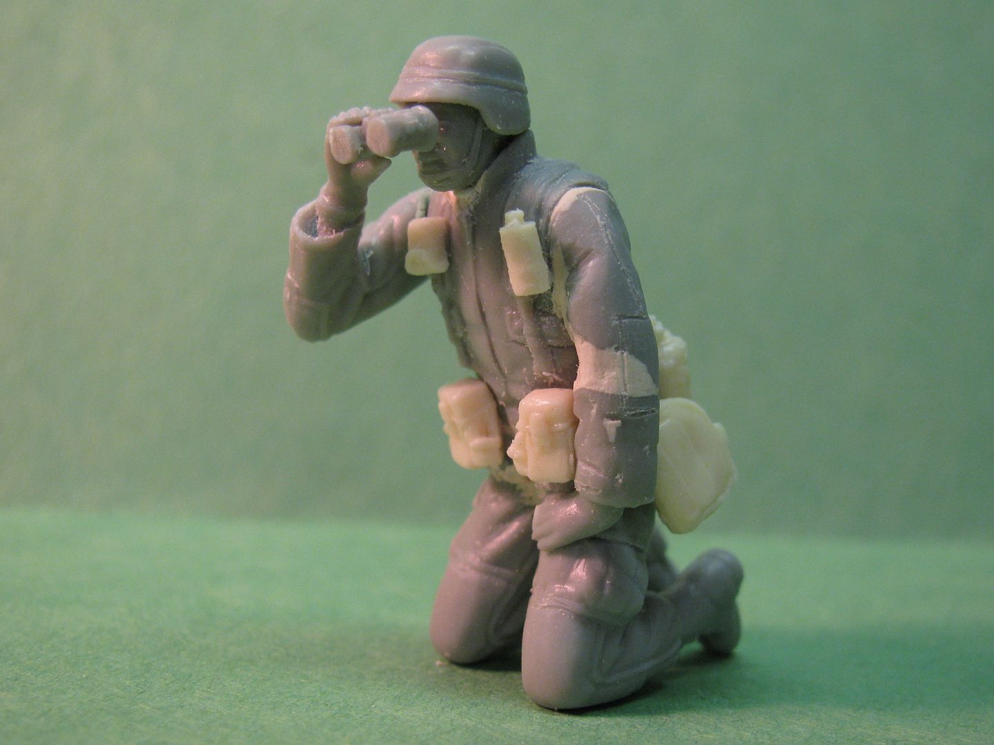

Here is the last member of the crew. He is all basically together and just needs a spot of putty here and there. Although his pose was the closest to the kit poses he was the hardest one to get to "look right" out of the bunch for some reason. Guys using binos are pretty hard to line up. This one is still not spot on but that is because of the clay temporarily holding his right arm on(I hope).
Getting closer to paint time. Yippeee! Not.
I should add that the arm isn't glued on yet as it makes painting the face a bunch easier without those binos in the way.

The hollowed out sleeves make such a difference, Jerry.
The Lithium battery holder was also a great addition.

I wanted to know if you plan to carve out the binoculars a little so there is a edge on the front to look like the glass is recessed.

Nice of you to say and thanks for noticing the details.Yes,I was planning on doing something about those binos. Might even try to replace them.

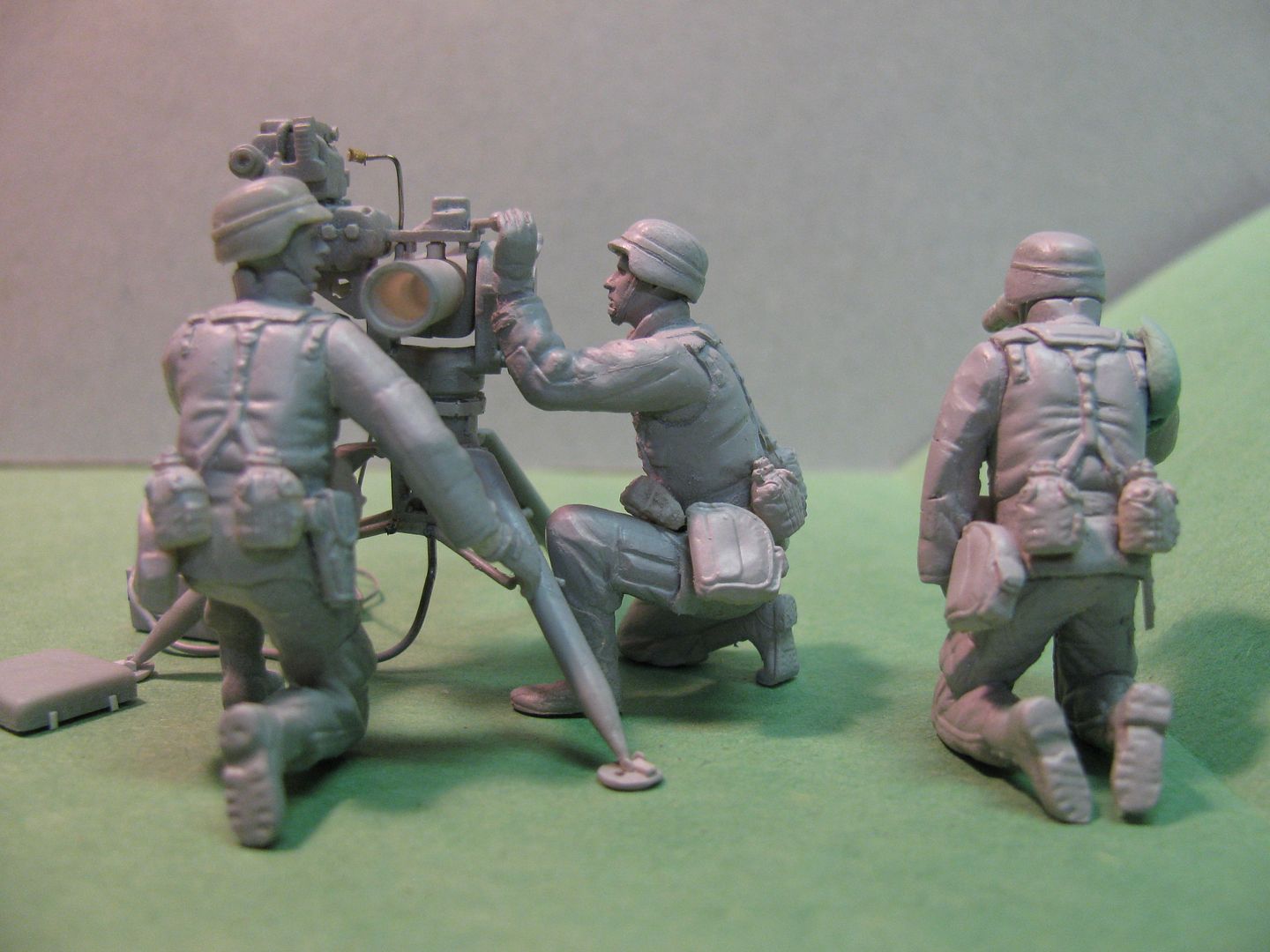

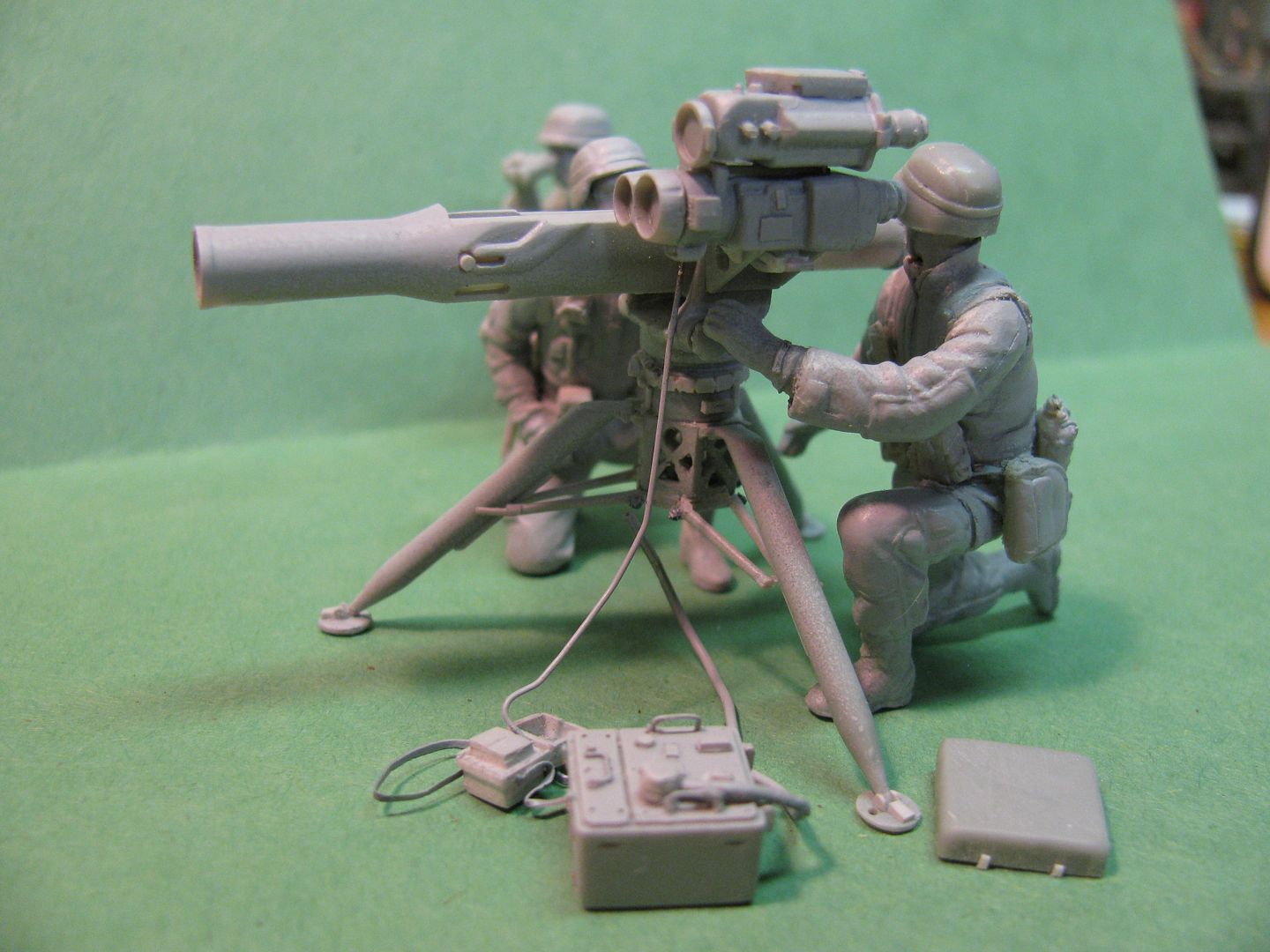

Here is an update with the primer shot onto it. Looks a lot better. Still have some work to do though.
The first time I built these figs years and years ago they just didn't look right to me and now I think it was because I didn't enhance the diliniation between the flak vest and shirt. There for the older figs just looked kind of chunky!!

Hi Jerry - as usual, you pass the primer test! Not an unwanted seam or gap to be seen! How do you always do it?!?? I like your tip on the guy's removable arm for painting - and the added chin strap - nice! Your fabbed up battery and control looks great. You're really burning through this one - wow!

I wonder how you always get the primer stage spot-on Jerry, as Nick mentioned. You have so many additions and changes to the figures yet you pretty much get them to look perfect under the very first coat of primer. I've never been able to do that- I always find a bit that needs to be re-textured or sanded so it blends in!
I must say looking at the scene all together under primer one can really begin to appreciate the work that has gone into making everything sit right, making it look right and adding in the correct details- it becomes so much more realistic with all the additions coming together.
Just out of curiosity- how long does it take to set up the TOW for firing and then how long would it take to re-load it after firing off a round?

Nice of you to say but there are still minor problems I see that need to be addressed. I don't think I have ever shot primer on for the first time and found no mistakes!! But thanks for the vote of confidence anyway!
I owe all of this focus on prep detail work to my awesome modeling buddy Mike Roof. He showed me down that road years ago.

Nice of you to say! As I told Nick above there are still mistakes though. I know I am harder on myself than almost everyone else is but hey....it makes me work harder.
The Tow can be put into operation in about one minute by a good crew. It breaks down into 7 main components for dismounted ops. Tripod,cradle mount,launch tube,daysight,nightsite,missile guidance set and nightsight battery box. The whole set up is pretty foolproof and the only thing that really needs delicacy is attaching the cable from the mount to the MGS. This connector has about 30 or 40 pins inside that if bent,render the whole sheebang useless.You then have to do a self check using the system in the MGS and this includeds boresighting the sights. There are two dials on the side and bottom of the daysight that have to be moved to line up the meters in the MGS. It sounds complicated but an average person can learn all this in a few hours at the most.
To reload takes easily under 30 seconds but a smart thing to do if you have time between targets is to re-test the system using the self check in the MGS
