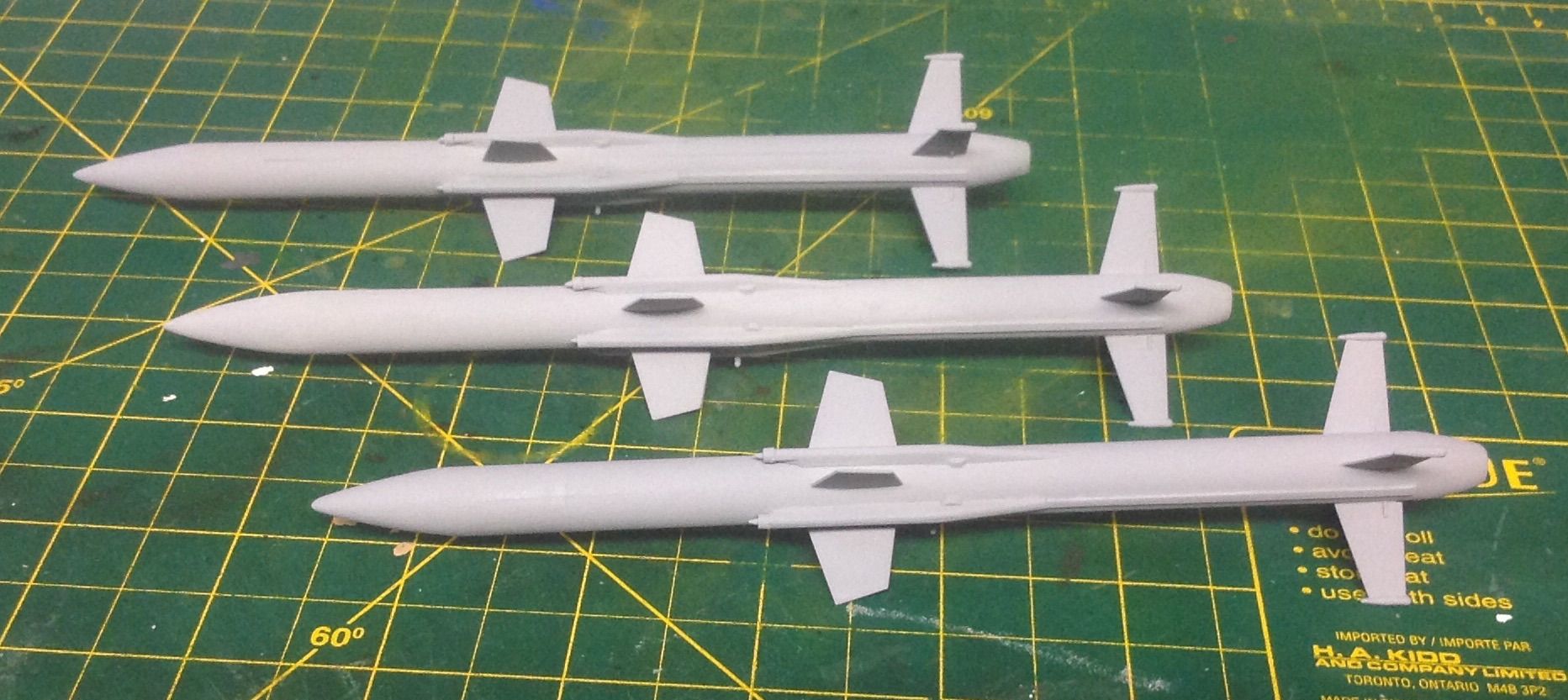

Eric,
That's generally a pretty nice kit; I built one a few years ago. In case you aren't already aware, a heads-up the kit missiles are too long and skinny for some reason, not to mention missing anything in the way of decals. There is an AM set of replacement missiles I wish I had known about when I built mine. Not only do they get the dimensions right, but they include a decent set of decals. I have also seen a tutorial online (forget where) on modifying the kit missiles to fix the dimensions if you are so inclined.

Hi Mark,
Yes I read about the missile diameter issues and actually started the rebuild last night using 3/8" styrene tube using the article by Andy Claesens on Military Modelling as a guide.
http://www.militarymodelling.com/forums/postings.asp?th=32946
I will have to check out a source for the decals.
Eric

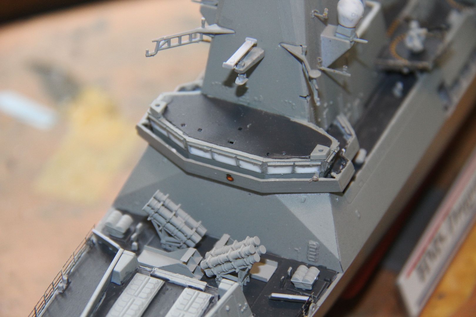

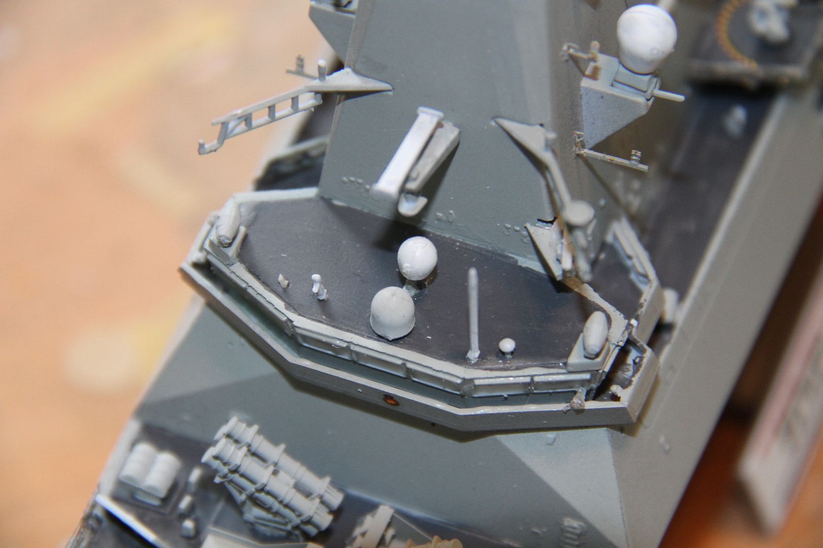

Posted: Thursday, October 22, 2015 - 10:29 PM UTC

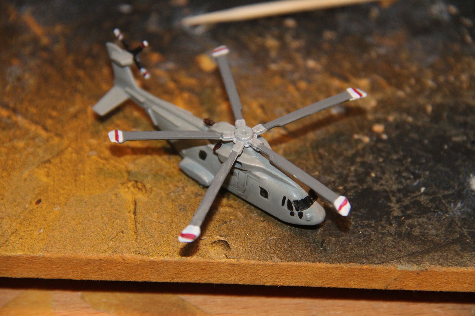

The bridge windows reglazed with Krystal klear. (Well I hope it will go clear.
Radars and aerials on the bridge roof.
And the Merlin Helicopter ready for decals.
More soon.
Si

Hi Folks,
Well I have started the corrections to the SA-6 undersized missiles. A bit time consuming but not very difficult. The missile at the bottom of the photo is one of the ones that came with the kit.
The one at the top is ready for the fins and booster rockets and the one in the middle is nearly to that stage.
Eric

Eric, looking good. How are you making the changes? Plastic tubing for new body and using the old missile cone?

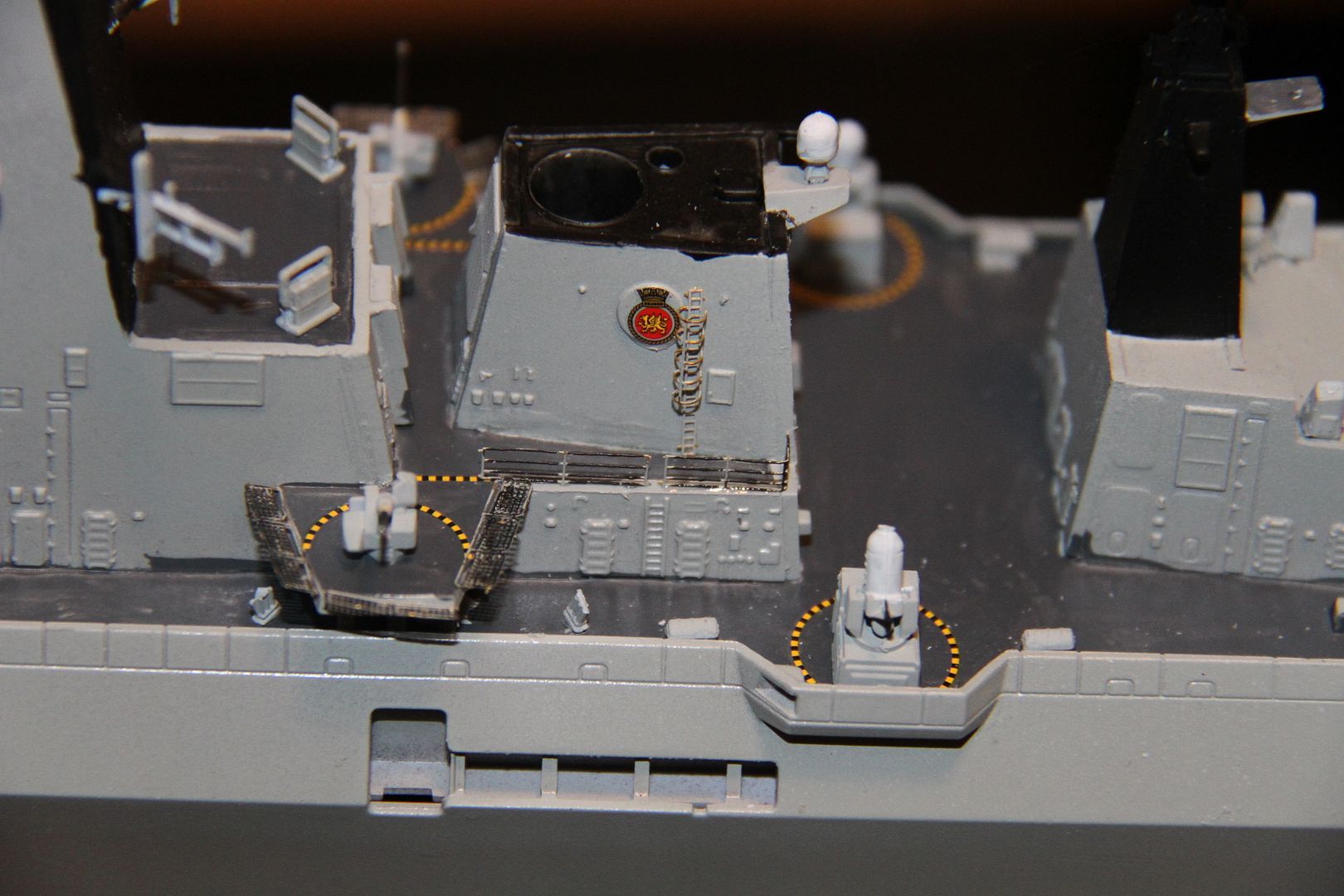

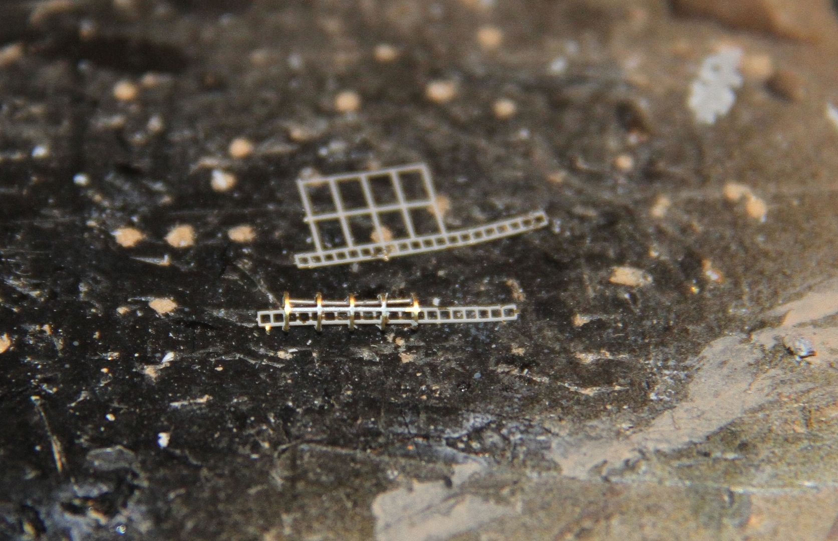

Thanks Jesper,
Getting there, the blood, sweat & bad language have been worth it.
Cage ladders for the funnel, one folded and on strait off the fret.
Fitted in place, along with the funnel deck railings.
The railings fitted to the missile silo, and showing the reglazed bridge windows dry.
Down to the final details now.
cheers.
Si.

Hi Jesper,
Yup styrene tubing for the body then styrene strips over the original cone to build up and reshape.
Eric

Eric, very nice job on the missiles. They look very menacing!

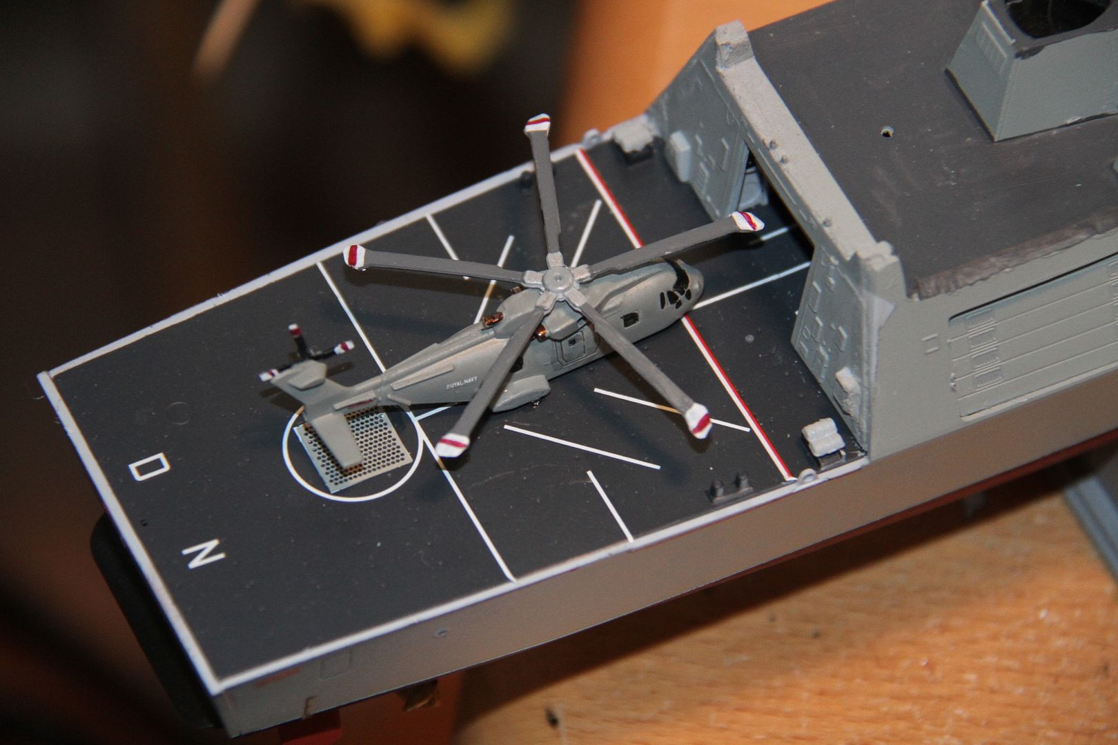

Posted: Thursday, October 29, 2015 - 11:31 PM UTC

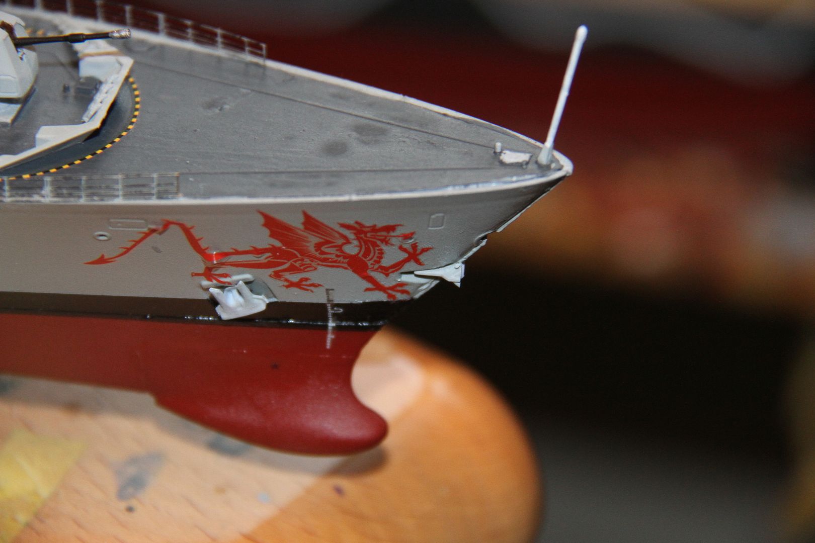

Small update on HMS Dragon.
The Merlin Helicopter decaled and fitted to the flight deck.
Anchors and jackstaff on at the other end.
More Soon.
Si

Looking great, Si! Close to the finish line of your great project. The result will be awesome!

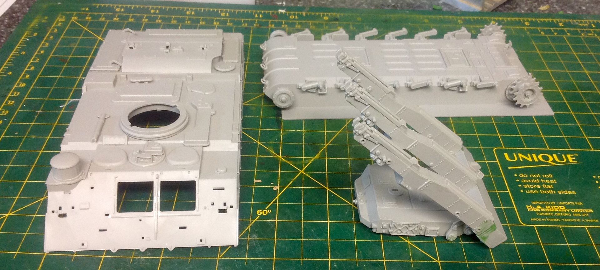

canuck100a
Nova Scotia, Canada
entire network: 96 Posts
Posted: Monday, November 02, 2015 - 07:33 AM UTC
Well the missiles have been modified and primed. So now work on the erector/launcher is underway.
Eric

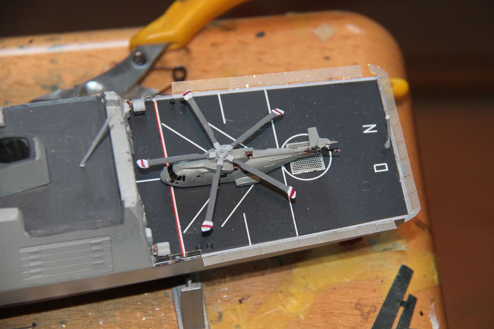

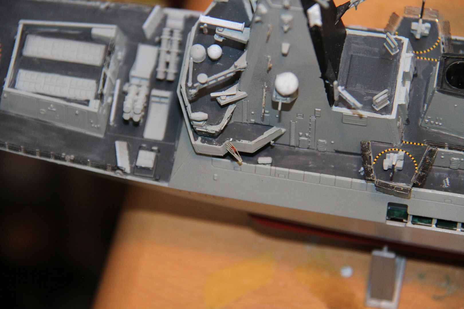

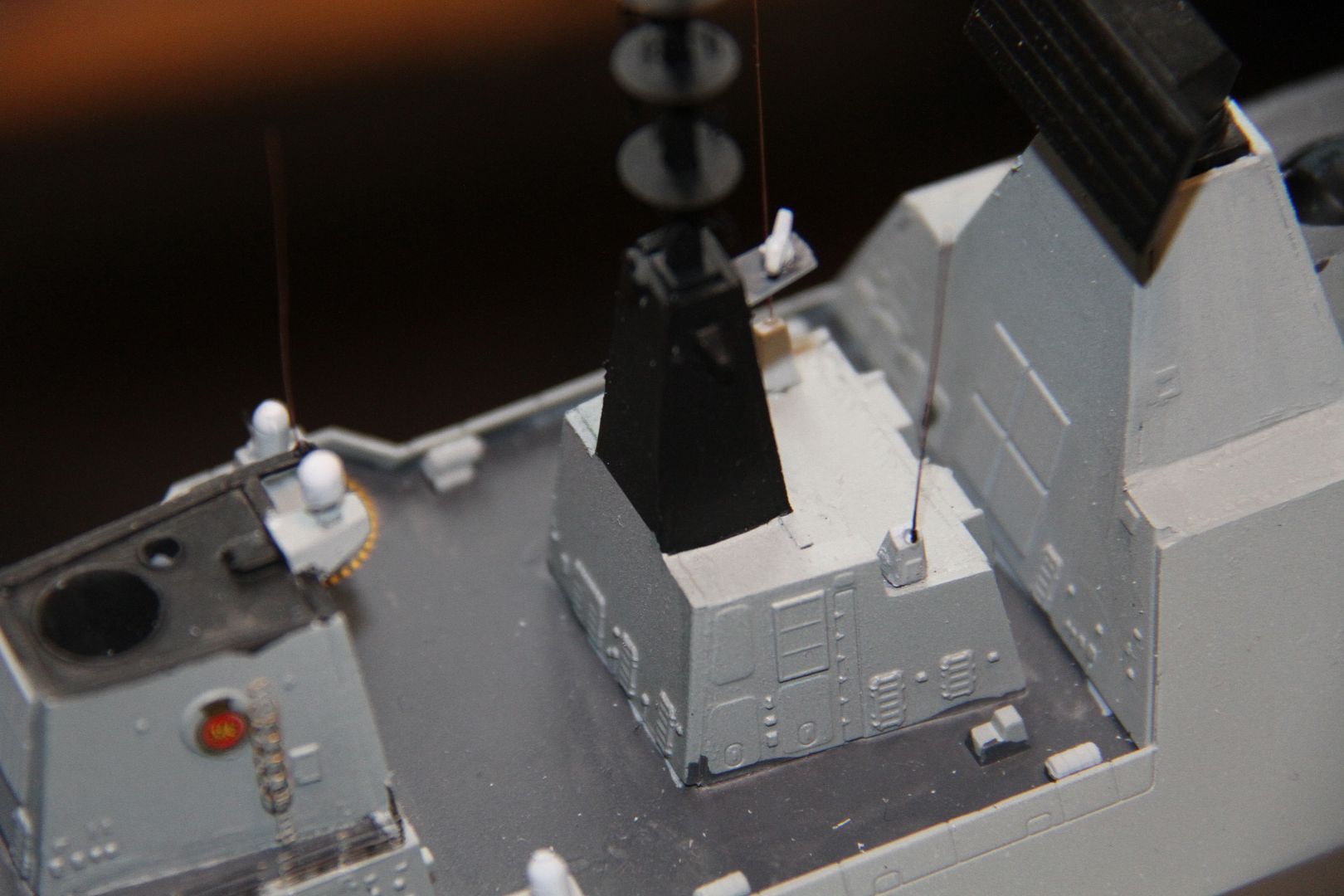

Posted: Monday, November 02, 2015 - 01:41 PM UTC
Thanks Jesper,
A bit closer to the finishing line.
A few more details added around the bridge and foremast. The white bit at thee top of the picture is a scratchbuilt replacement for one of the sensors / aerials that was eaten by the floor monster.
The big pole aerial on top of the hanger and the safety netting on the flight deck.
Just a few minor details to go and she will be done.
Si

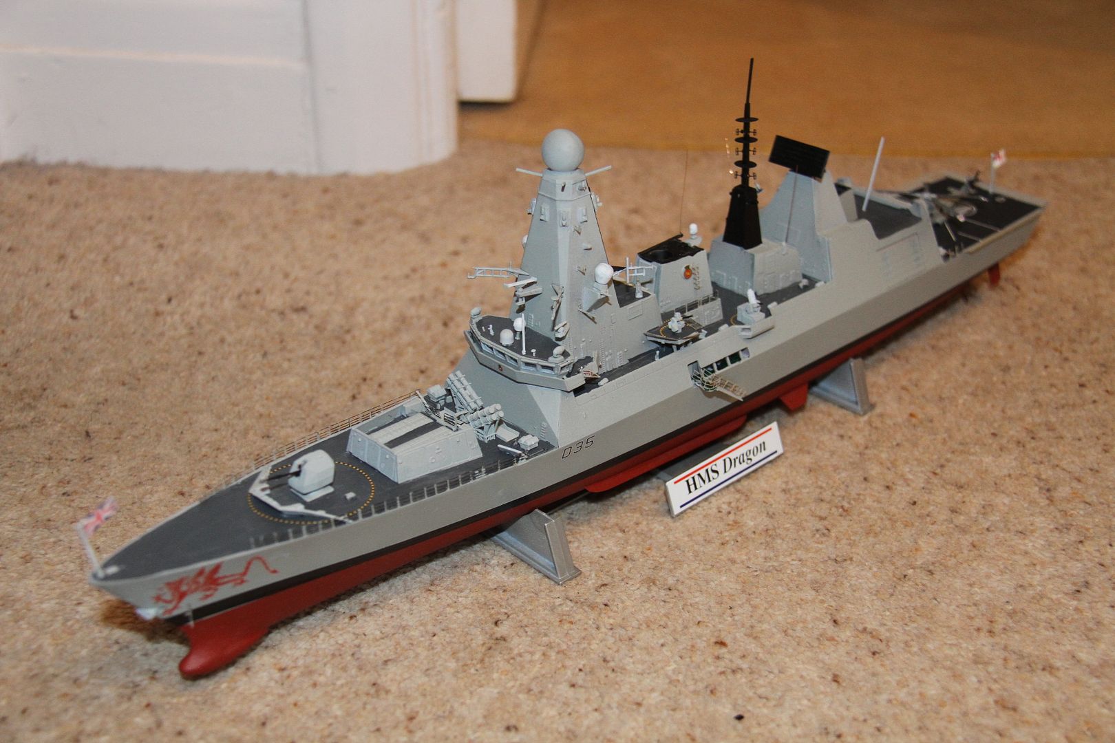

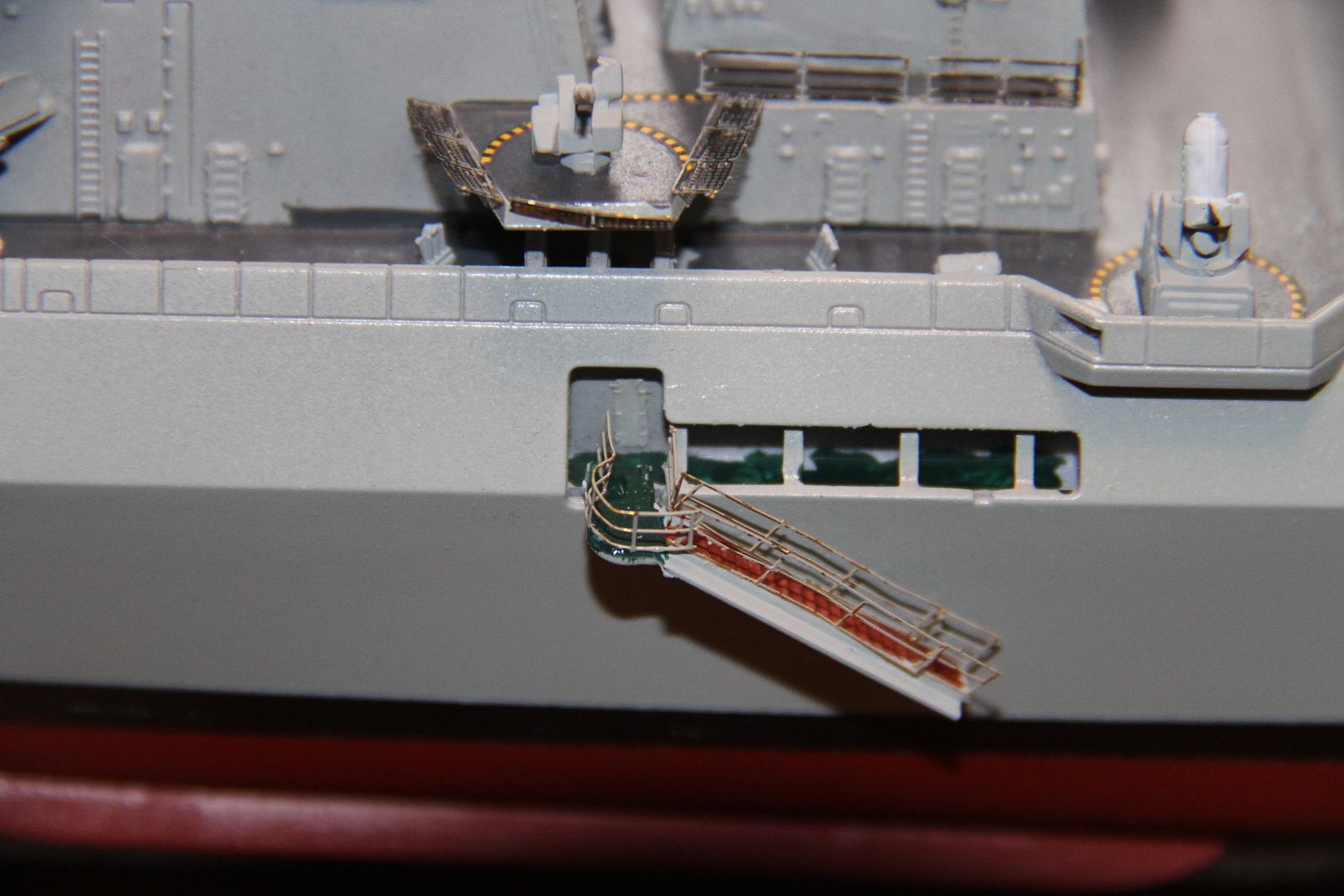

Posted: Monday, November 02, 2015 - 10:38 PM UTC
The gangway finished off with some scrap left over railing.
Whip aerials in place around the midships area.
Jack and ensign on, and job done.
Will put some pics in the gallery of both builds.
Cheers.
Si

Howdy Y'all
@Tat-you're a brave man. Great work!
@Si-once again, you've given us a superb model. I always enjoy watching your builds.
