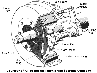

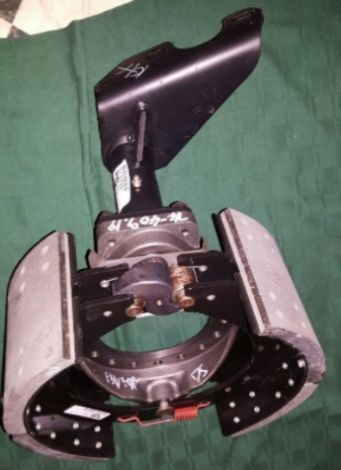

Michael - The actual "S" part of the S can is inside the brake drum, but there is a shaft/tube that comes outside of the back of the brake drum area that attaches to the slack adjuster.. That also attaches to the brake chamber.
entire network: 8,953 Posts
KitMaker Network: 163 Posts
Posted: Saturday, August 13, 2016 - 03:44 AM UTC
Dustin, I almost went back and posted the remark that the slack adjuster does attach to the opposite end of the shaft the S cam is on.
Again I won't know until the Real Model resin parts arrive. Also, so far I have not found a good photo or drawing of how the brake actuator mounting brackets are laid out on the HEMTT.
Found one!

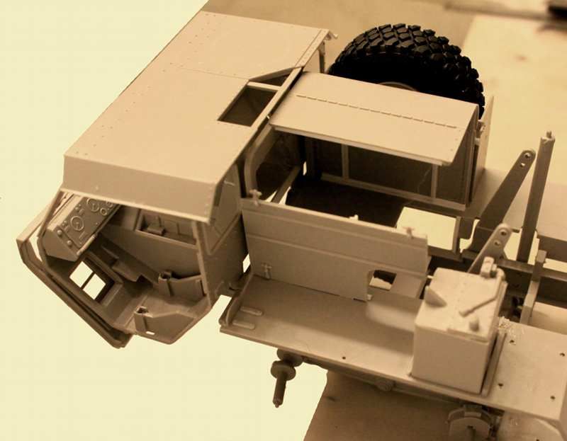

Posted: Saturday, August 13, 2016 - 03:47 AM UTC
Took this vampire out into the sunlight to take some progress photos. Don't know for sure these add anything you guys and gals have not seen already.

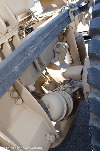

Posted: Saturday, August 13, 2016 - 04:08 AM UTC

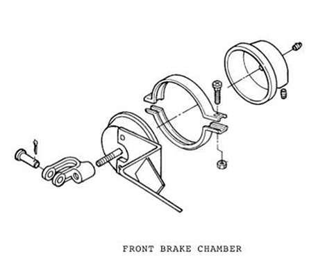

The bracket that the brake chamber bolts to, and the S cam goes through is pictured here.

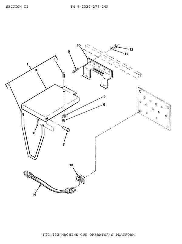

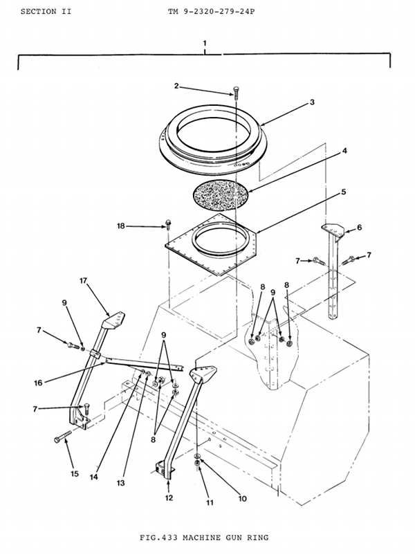

Posted: Saturday, August 13, 2016 - 08:24 AM UTC
Photographer uncredited

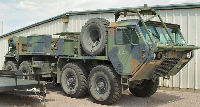

Anyone know of a gun ring kit available separately that I could add to my HEMTT? (Clearly the Italeri gun truck has one.) Is there any other source?
I can probably scratch the framework but the traverse ring could be the problem.
Did you know the gunner has a removable platform to stand on?

I have 8 of those round air brake things from my Trumpeter Patriot kit and an older style gun ring kit you can have if you want.

I have the rings from both the m923 and the m35 if you need them.

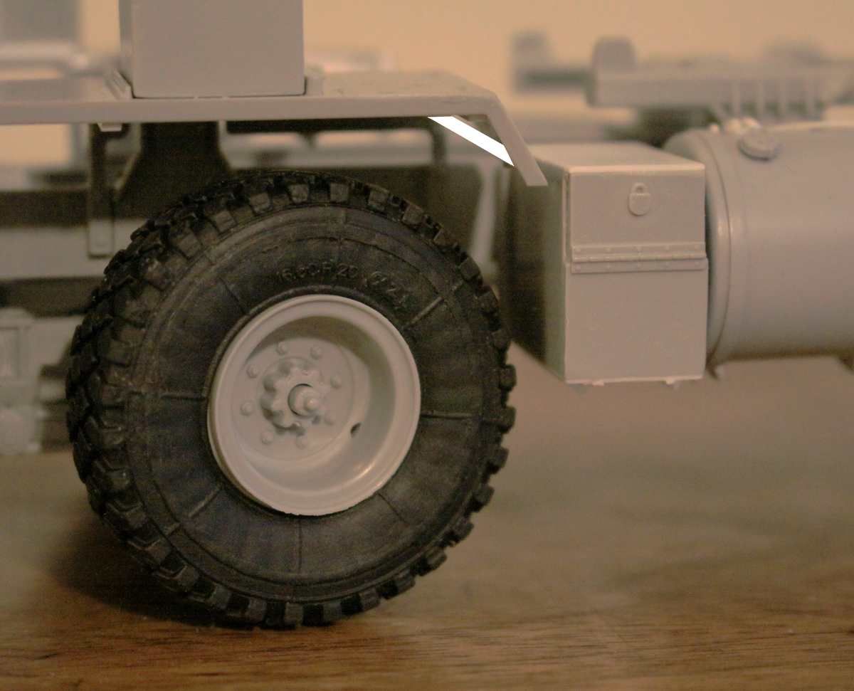

Posted: Saturday, August 13, 2016 - 06:29 PM UTC
A small added detail plus finally, a good look at those new Italeri rubber tires:
Small angle brace added to the fenders.

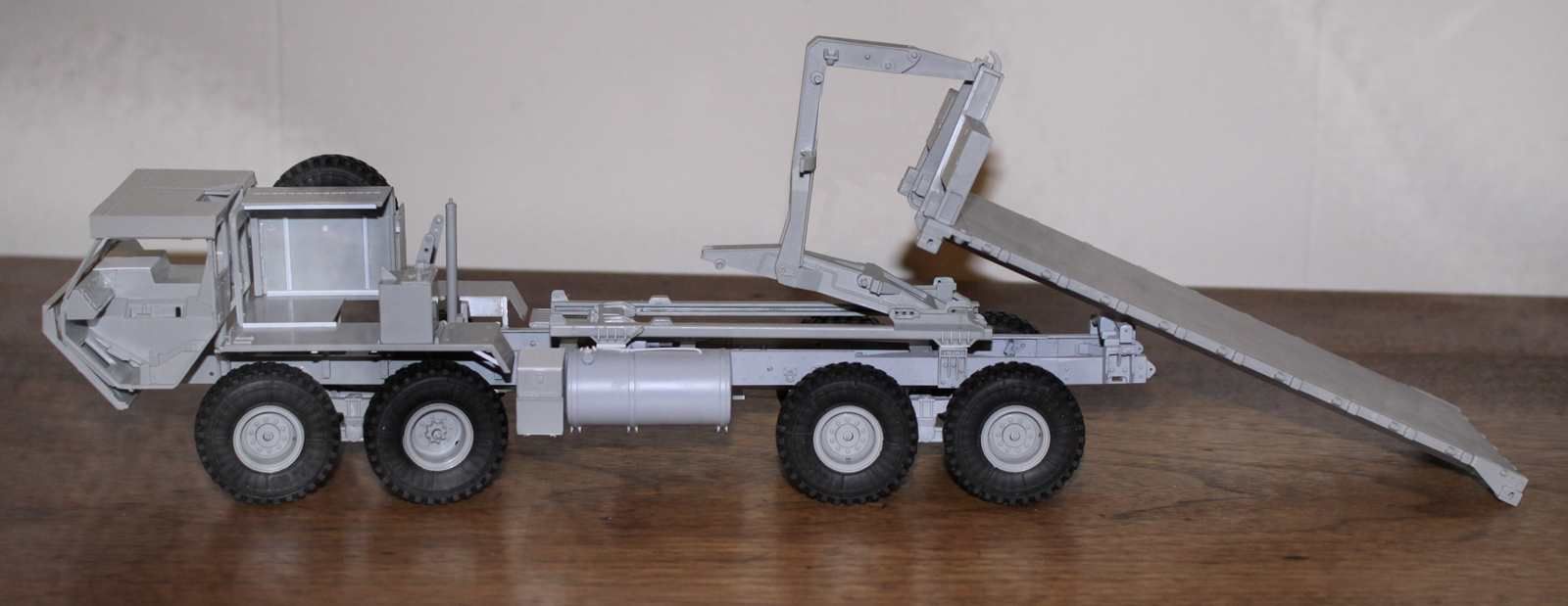

Posted: Saturday, August 13, 2016 - 06:34 PM UTC
AND . . . . a shot that up till now I have not thought to take:
p.s. I started to buy the new Italeri 20' container at the same time I bought this model. Then I thought I might end up building my own load or go in a different direction entirely so I put my wallet back into my pocket.

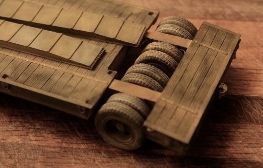

These are rubber tires on this HobbyBoss White 666 semi-tractor. (My conversion)
These are painted resin tires on this flatbed trailer.
All weathered using pastels.

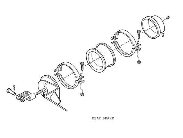

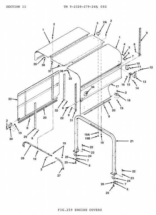

Posted: Saturday, August 13, 2016 - 08:47 PM UTC
More on the brakes:
Did a little photo retouching last night - starting with drawings from the TM. Here I have eliminated the internal workings of the HEMTT brake actuators so the external "look" can be seen.

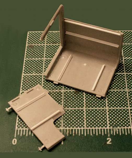

Posted: Saturday, August 13, 2016 - 10:04 PM UTC
A few more minor details:
