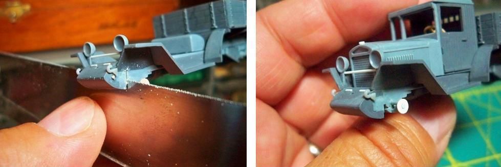

DOH!
Now that you point it out, Peter, I see that you are right! The molded triangular depression is indeed exaggerated, but the main reason that the radiator housing below it appears less rectangular than it should is because the angular fitting at the lower front (part F6) is too high, covering the lower part of the radiator.
This is my fault. I uncritically followed PST’s instructions to trim off the molded bumper and attach the angular fitting F6 to the chassis frame. There is even a handy slot provided at the back of the fitting which slides it perfectly into place there. The problem is, this mounts the fitting too high!
So I cut the chassis again... and reattached F6 in a lower, more correct position.

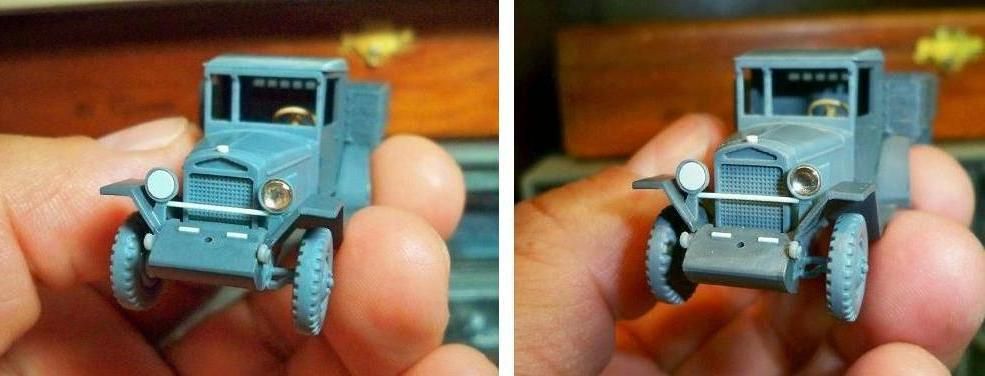

The final result is not dramatically different, but the “after” picture on the right more accurately reveals the rectangular shape of the radiator.
Thanks for the heads-up on this, Peter!

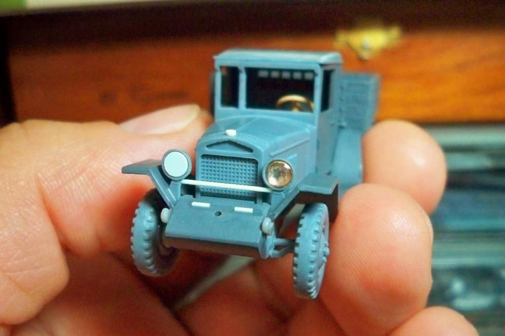

I kind of like that Tim, a little unusual and quirky. I have never had a vehicle wink at me before.
I note the radiator housing seems a little different to the pic, the triangular depression looking larger and deeper with the bottom section of the triangle lower down, making the radiator more square than rectangular.

I replicated this on the model with a MV Products L 128 (3.26mm) clear lens on the left side and the right side blanked off with a .010 inch plastic disc made with a Waldron #5 (.120) punch.
It looks a little weird; I haven’t decided whether to go this route or simply install a second MV lens in the right side as well.
