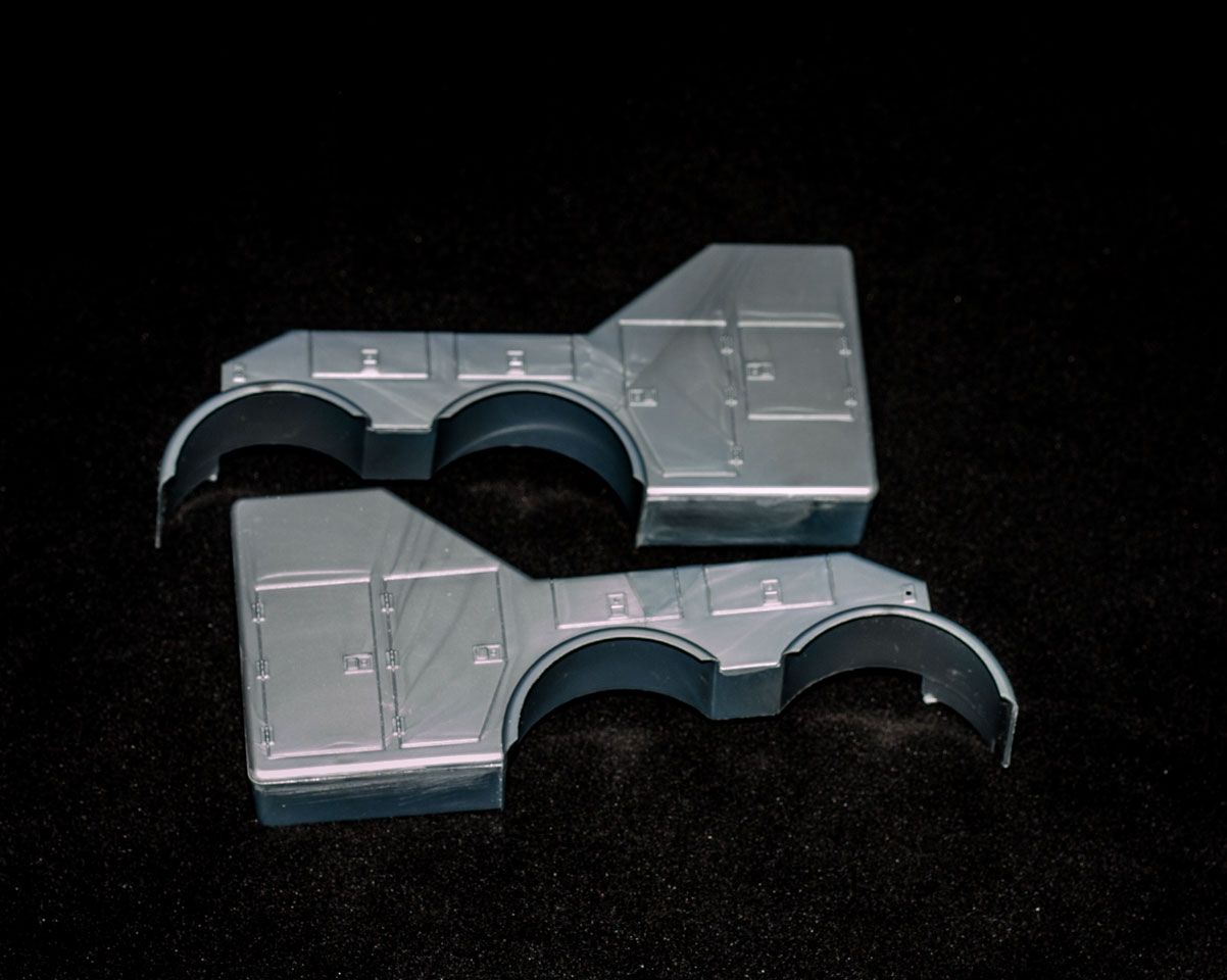

I hate model chrome!
Here is a photo befor hitting with oven cleaner;-
And after:-
Next up some glue and then prime.
And after:-
Alclad and Bare Metal after primer.
Hi Richard,
How do you do this? Spray and leave it to soak? How long does it take? does it need to be scrubbed off or does it wash off? Sorry for the inquisition, I haven't seen this before.
entire network: 6,161 Posts
KitMaker Network: 538 Posts
Posted: Saturday, January 20, 2018 - 11:04 AM UTC
Hi Michael .
I put the sprues and parts in a ziplock bag, fill it with Mr Muscle oven cleaner foam, seal it up and leave it overnight. Hit it with a toothbrush in a sink of warm water and the chrome should come off easily leaving you with clean bare plastic. A couple of times I have had to repeat it to get some stubborn chrome off, but this is rare.

Posted: Saturday, January 20, 2018 - 06:16 PM UTC
Hi Michael
I use regular oven cleaner, the stuff I use takes the chrome off in about 10 minutes.
The parts are placed in a plastic tray,sprayed then I use a plastic brush to scrub parts.
Wash off slime with cold water and then set aside to dry.
I will give the parts another clean before painting.
Removed locating pins on the tanks and now correctly line up!
