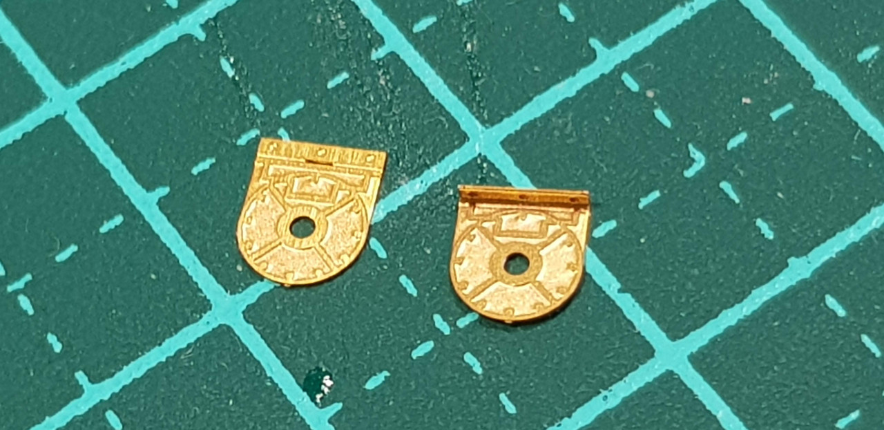

I started with the cradle and shield..
I added the shield to the support arms like so.

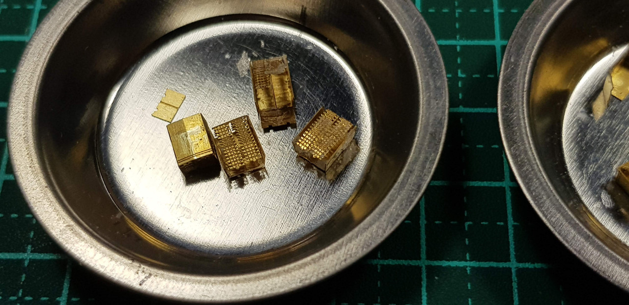

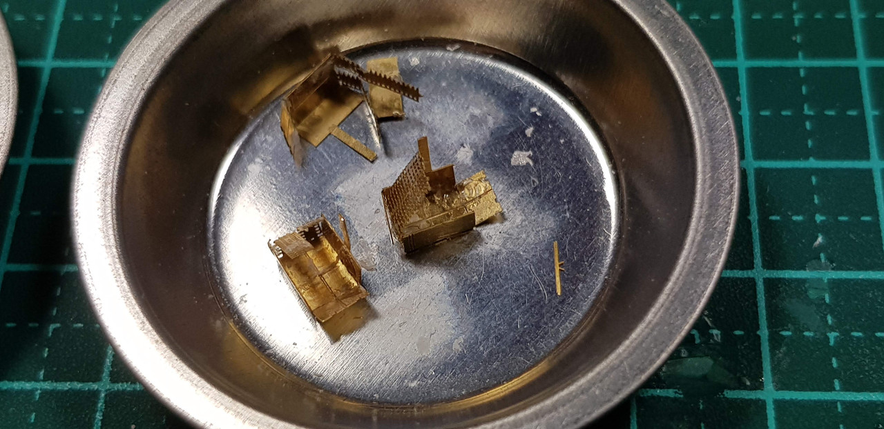

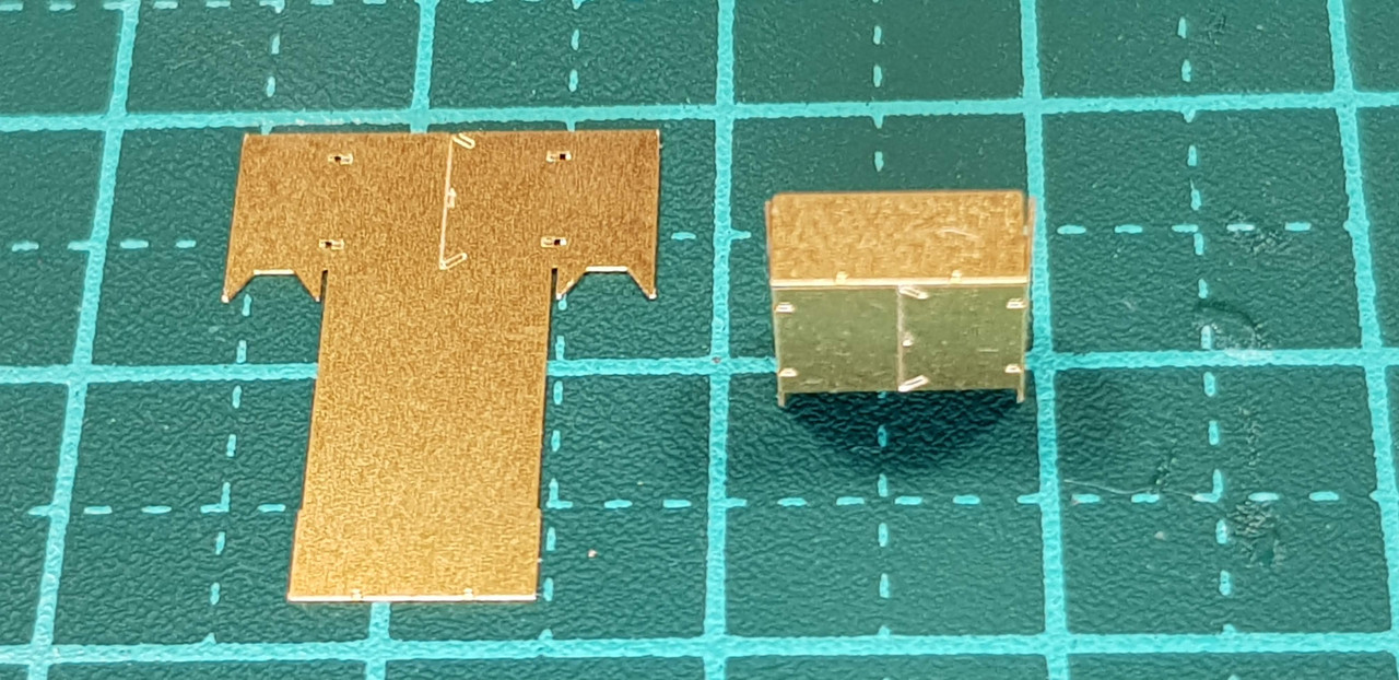

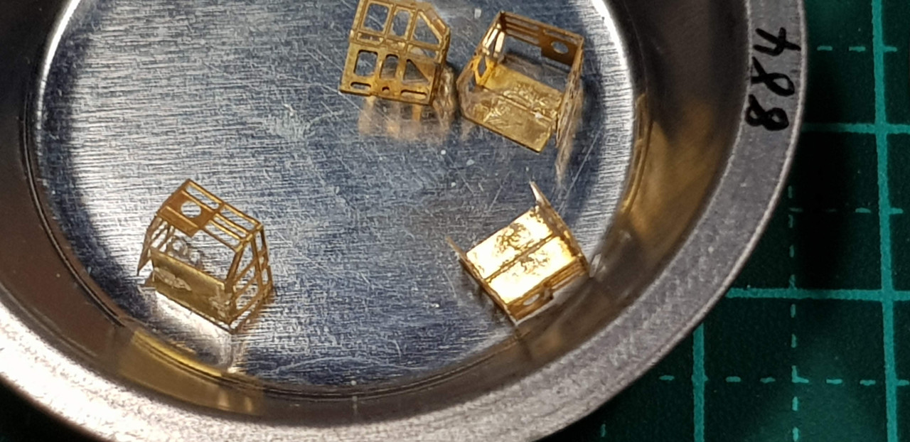

I continued on following the instructions and folded up one type of the numerous ammo boxes and lockers..

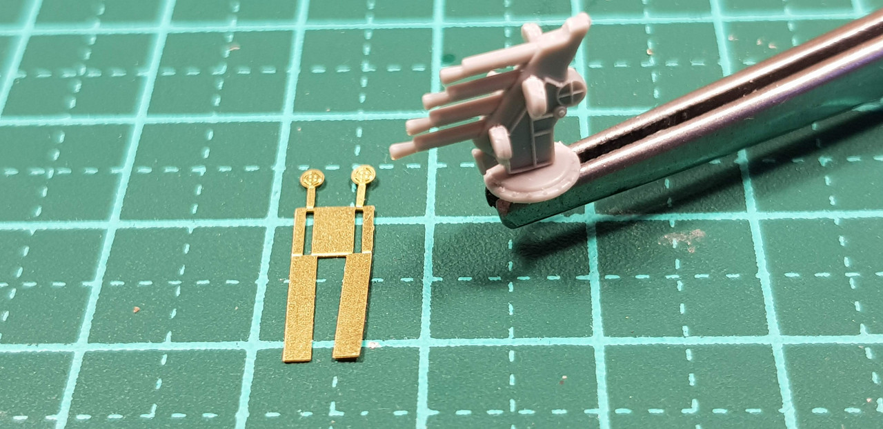

Next up were the 0.2in Quad Vickers guns. Oddly Pontos provide no brass for this in this set but the HMS Hood set has four of them provided. I put them together except for the PE..
Then looked so lame I decided to have a look online and Shapeways have beautifully printed sets inline. I ordered a sit and we shall see how good they are. I didn't do anymore on the plastic ones. Shame on you Pontos for not providing at least brass barrels!

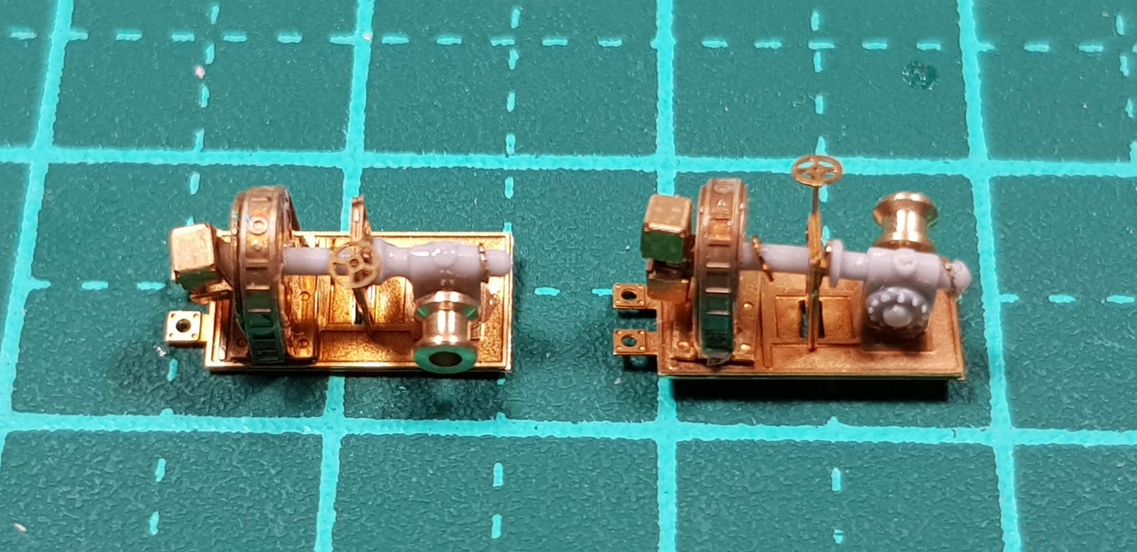

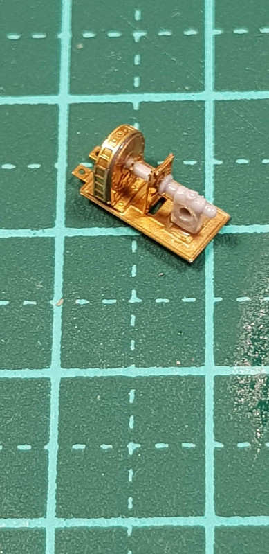

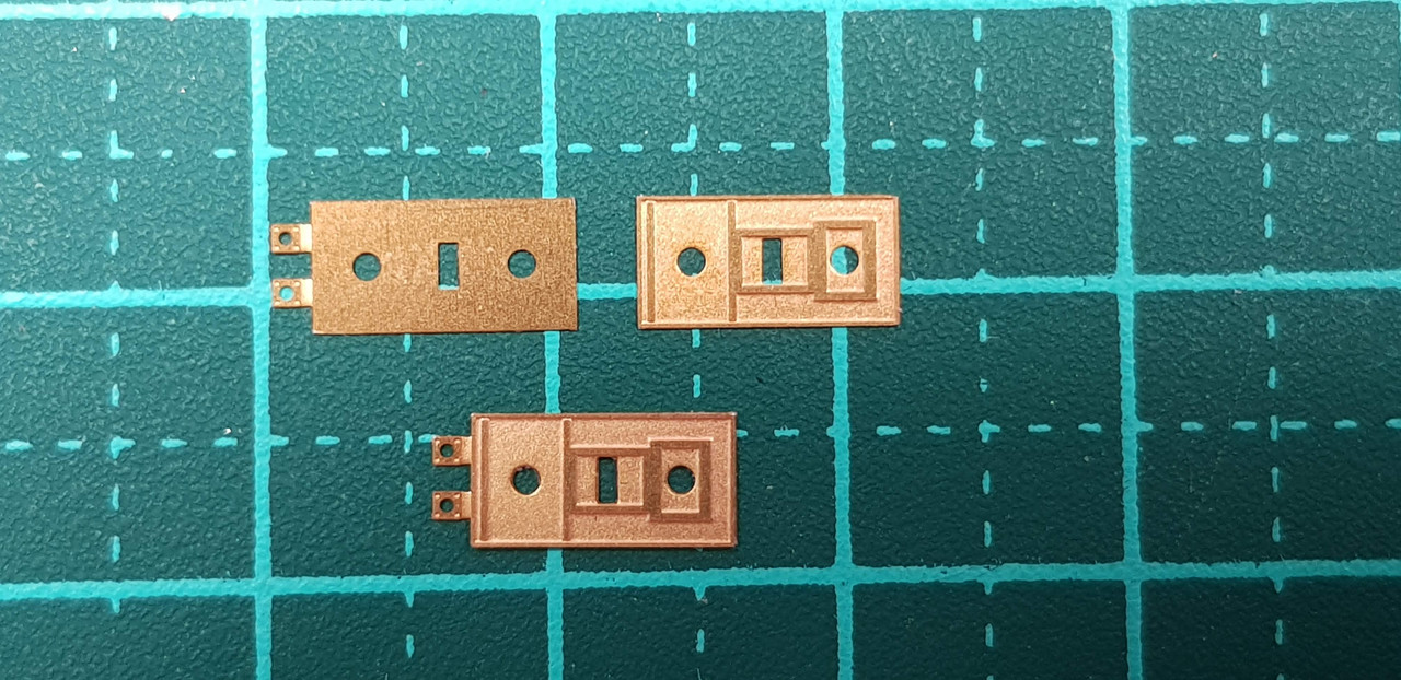

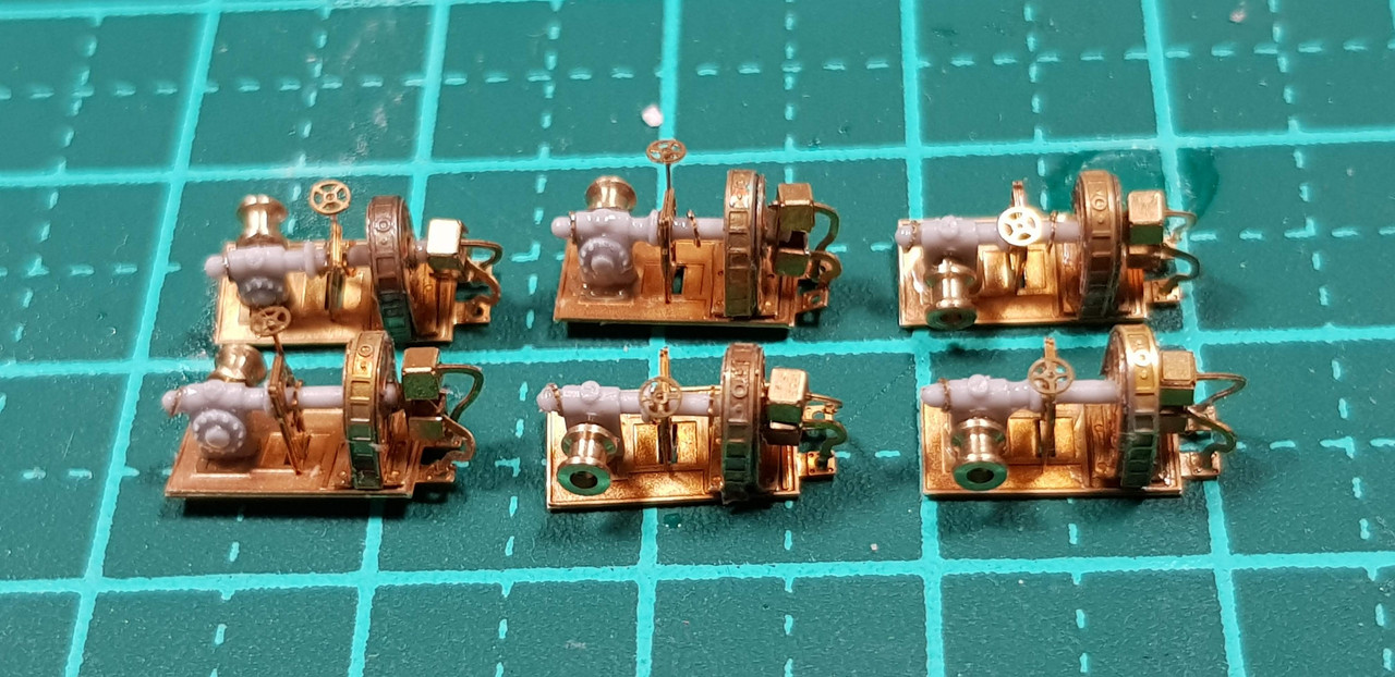

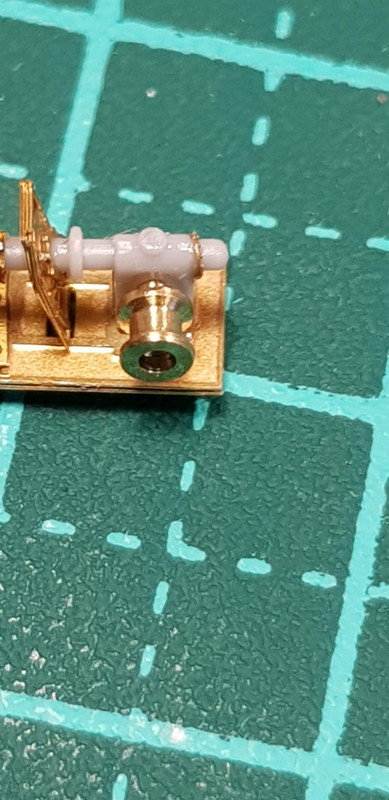

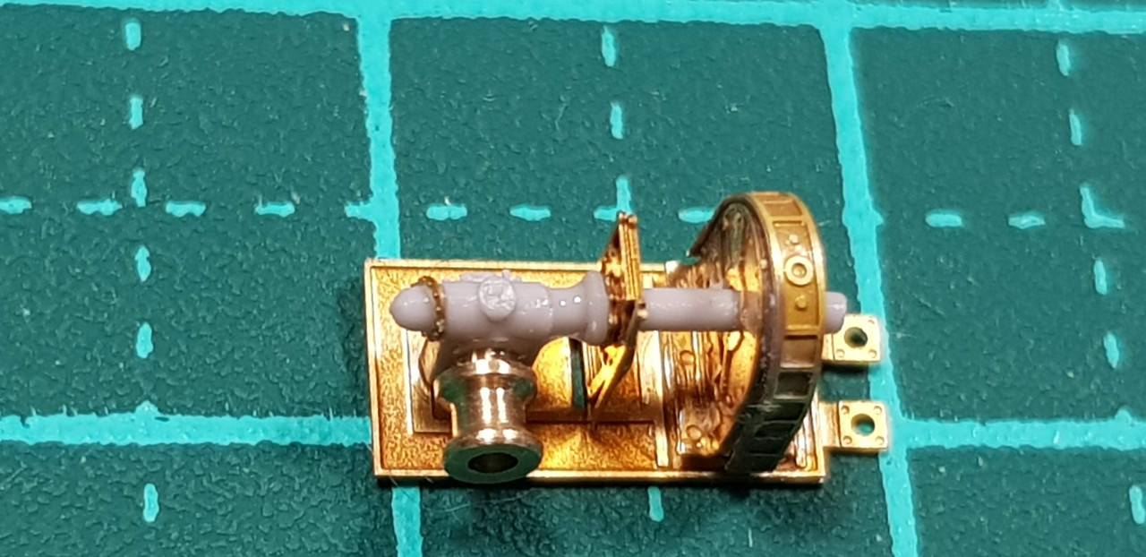

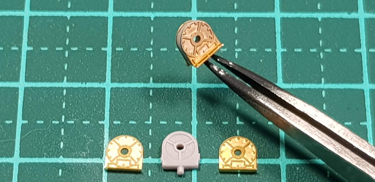

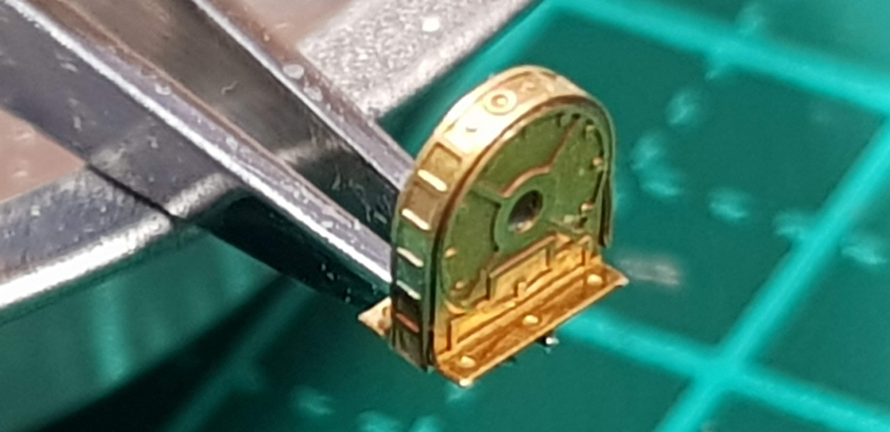

Next up in the fabulous Rodney show is the construction of six small winches. Each winch in just over 10mm in length and abut 5mm in length but they have more than 15 parts in each of them. First step is to glue too pieces of PE together to form the base of the winch..
After this you need to assemble the motor from two pieces of PE and one of the plastic kit parts after you have put two small bends into the ends of the motor assembly..
Then they get attached to the sides of the kit's plastic motor..
As you can see the PE parts increase the detail markedly. Next you need to curve some PE to place over the outside of the motor. To make it easier to curve this slightly thicker PE you need to anneal it first. This is done by heating it until it changes colour. See the one on the left has changed to lots of colours..
After that you can curve them much more easily using the curving tools I showed earlier and you get a cover for the motor that goes on the outside and adds more detail to the little winch.
Next is what looks like some sort of control item part way along the shaft which gets folded in half and the threaded onto another plastic piece from the kit and after adding a couple of tiny spacers the whole lot gets pushed through the motor and attached to the base plate.
The you find the brass winch pully, trim it up a little and add it to the plastic part..

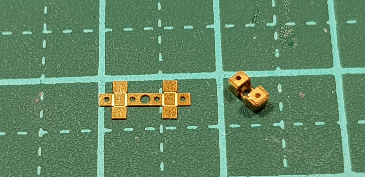

Next up is an assembly that folds up into a couple of boxes on a bracket that pipes go into from the base.
You attach that and the little control wheel to the control piece in the middle and the box to the end of the motor..
Next up you cut the tiny pipes off and add them to the box and base and it is finished. The pipes are a little two dimensional but I am sure it won't be noticeable once the winch is attached to the deck.
This item is a great example of how PE can enhance the details of an item far above what can be provided by just plastic parts.
That's it for now.
