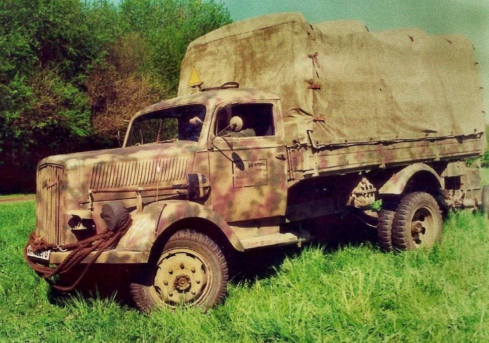

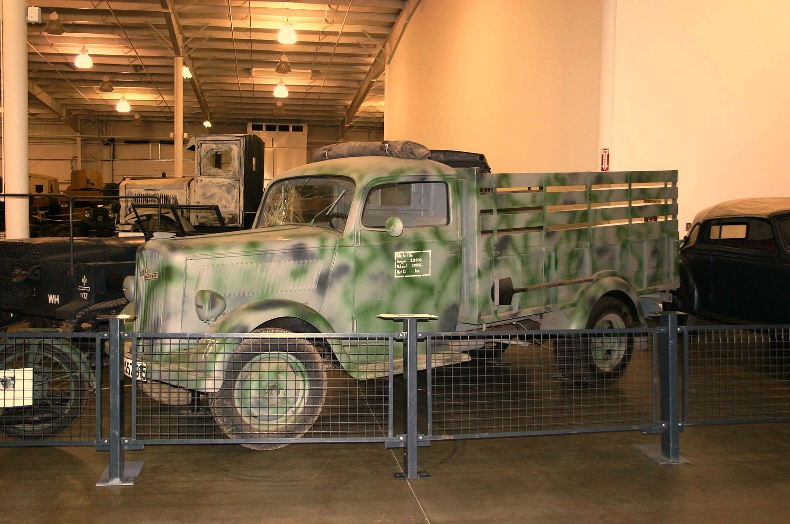

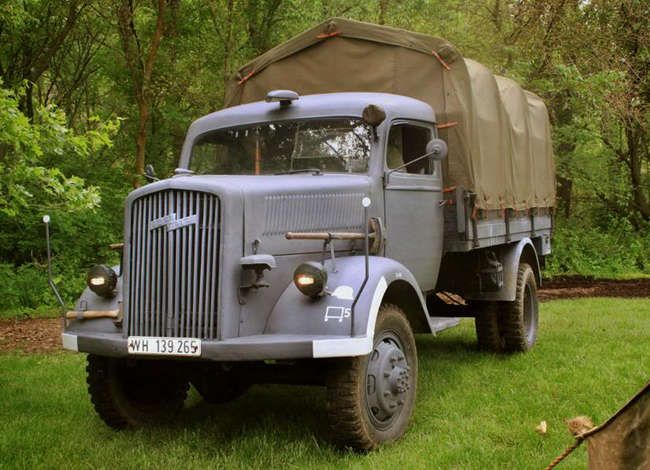

entire network: 9,132 Posts
Posted: Sunday, May 19, 2019 - 04:17 AM UTC
I had hoped you would ask. - My only motive here is the shareing of information.
As to the 4x4 cab:
- The entire cab/hood/fender assembly sets higher on the frame.
- Fenders are set roughly 5-6 inches lower relative to hood.
NOTE: bottom edge of bonnet cover is perfectly straight and does not arch up over curve of fender as on 2x4 cab.
- Fenders are also set 4-5 inches farther to rear as vehicle front axle is more rearward to help differential clear the underside of engine oil pan.
- Fenders are so far back that the rear edge cuts into front lower corner of cab door.
- Front bumper sheet metal is part of body sheet metal rather than separate piece of more traditional spring steel bumper.
2x4 cab:
- Sets lower on frame.
- Fenders higher relative to hood and further forward.
NOTE:bottom edge of bonnet (hood) arches up over curve of fender.
- Fenders are far enough forward as to not interfere with cab doors.
- 2x4 cab has traditional pressed steel bumper mounted as separate piece to front frame extensions.
Examples:
Typical Opel Blitz 4x4's:
Typical Opel Blitz 2x4's
All Photos Copyright Michael Koenig 2009 - All rights reserved.
