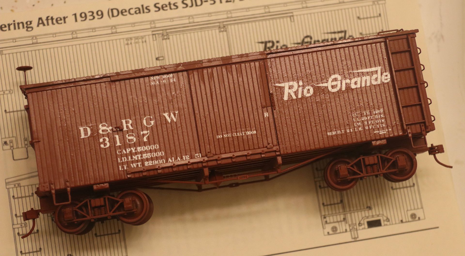

OK, I admit this may no longer apply to the subject at hand. I am just posting it as an informational share to the group.

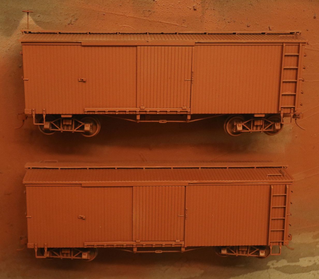

Fresh paint - Tamiya Red Oxide Primer (New color from Tamiya.)
Decals applied - Future Floor Wax applied by brush both under and over the decal to entome the transfers and hide the edges. (No Solvset used)
I know this looks gross (bad) however please read on.

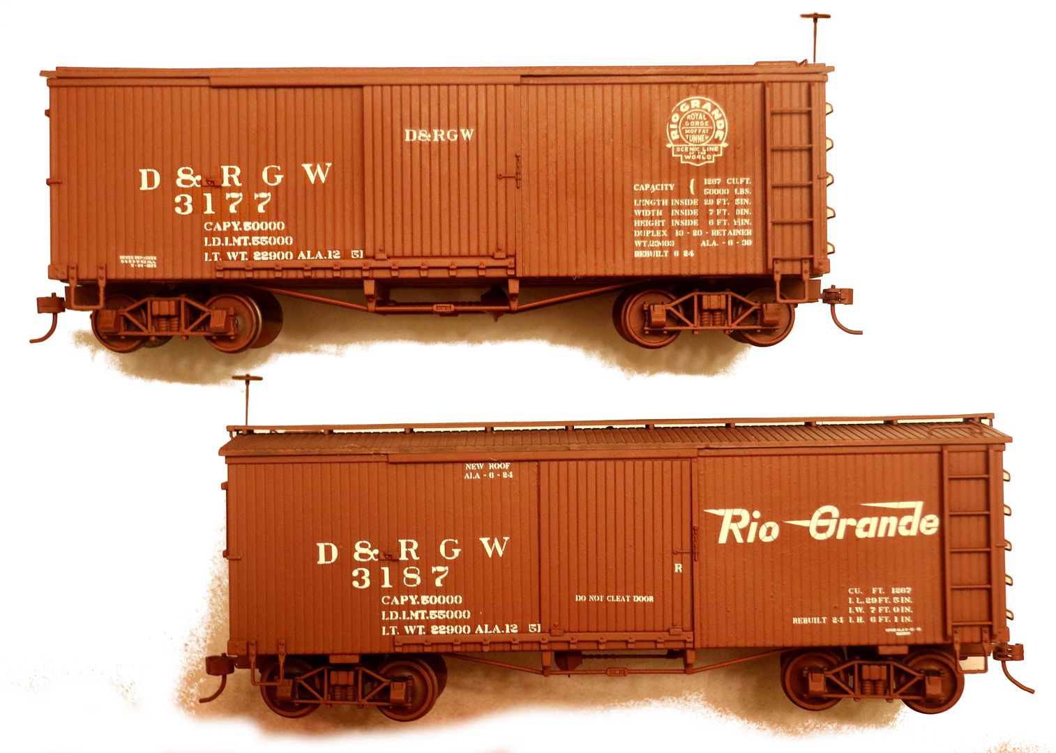

Finished models - Tamiya Flat Clear (TS-80) applied over the fully dry Future Floor Wax - Clear is first applied heavily, then allowed to dry - Final coating of clear was sprayed at a distance (18" to 24") and allowed to go on as a dry dusting.In the final dusting the Flat Clear paint "falls" on rather than being sprayed onto the model.

New Tamiya color RED OXIDE:
Good for Model Railroaders and Armor alike!
