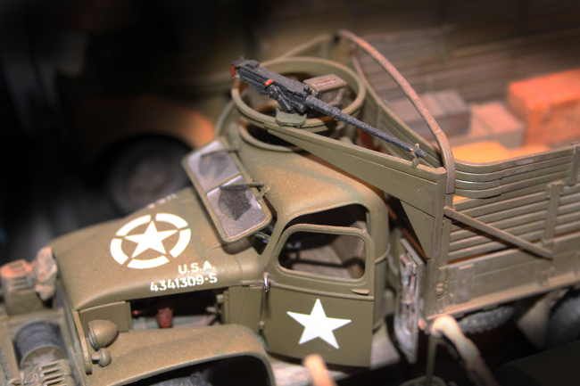

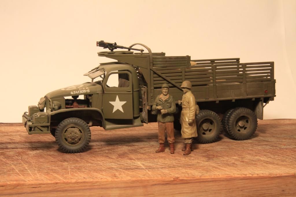

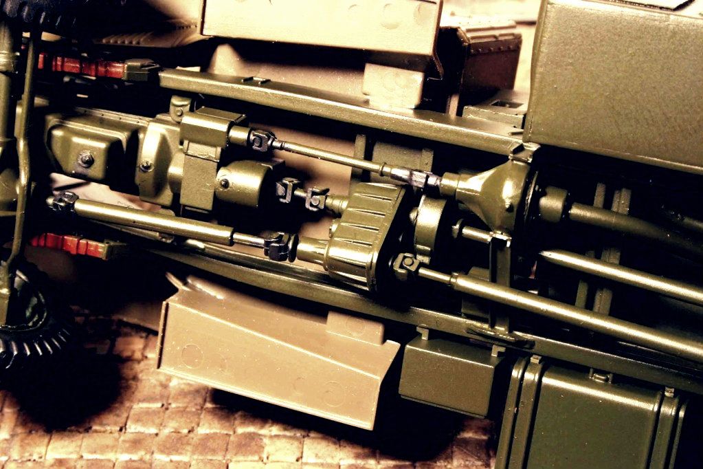

Italeri "Gun Truck" cab on stock Tamiya chassis with Tamiya loadbox.
Italeri "Water Truck" cab on shortened Tamiya frame to make Chevy 1 & 1/2 ton 4x4 truck with shortened Tamiya loadbox.

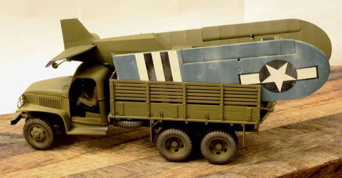

Italeri 'Water Truck" cab on stock Tamiya chassis with Tamiya loadbox and Bronco L4 Piper Grasshopper. (Work In Process)
Italeri 'Water Truck" cab on Tamiya chassis with modified Italeri water tank to make Air Corps flightline fuel truck. (Work In Process)
Italeri 'Water Truck" cab on slightly modified Tamiya chassis and loadbox with Masters Productions rail wheels. (Work In Process)
entire network: 9,154 Posts
Posted: Tuesday, October 22, 2019 - 03:44 AM UTC

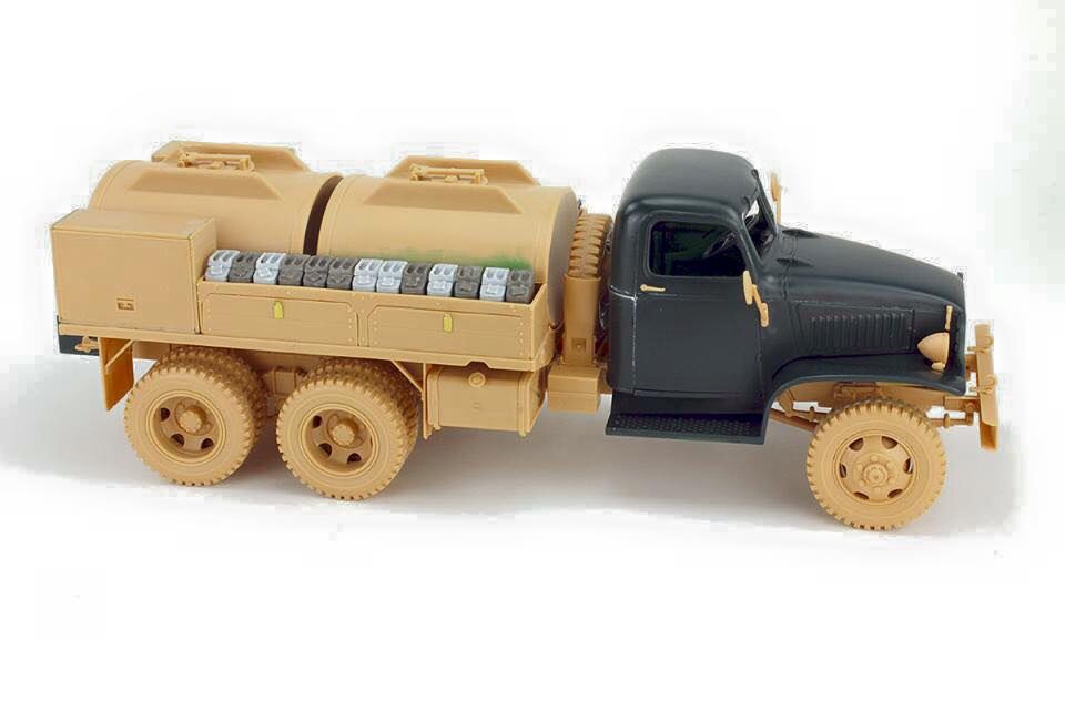

Combined Italeri and Tamiya cab on HobbyBoss SWB chassis. (Work In Process)
Spare tires and fuel tank yet to be installed behind cab.
Like I said: Beautiful HB firewall - highly recommended! (Am cutting open the hood on this one just for an extra challenge and to show all that detail.)

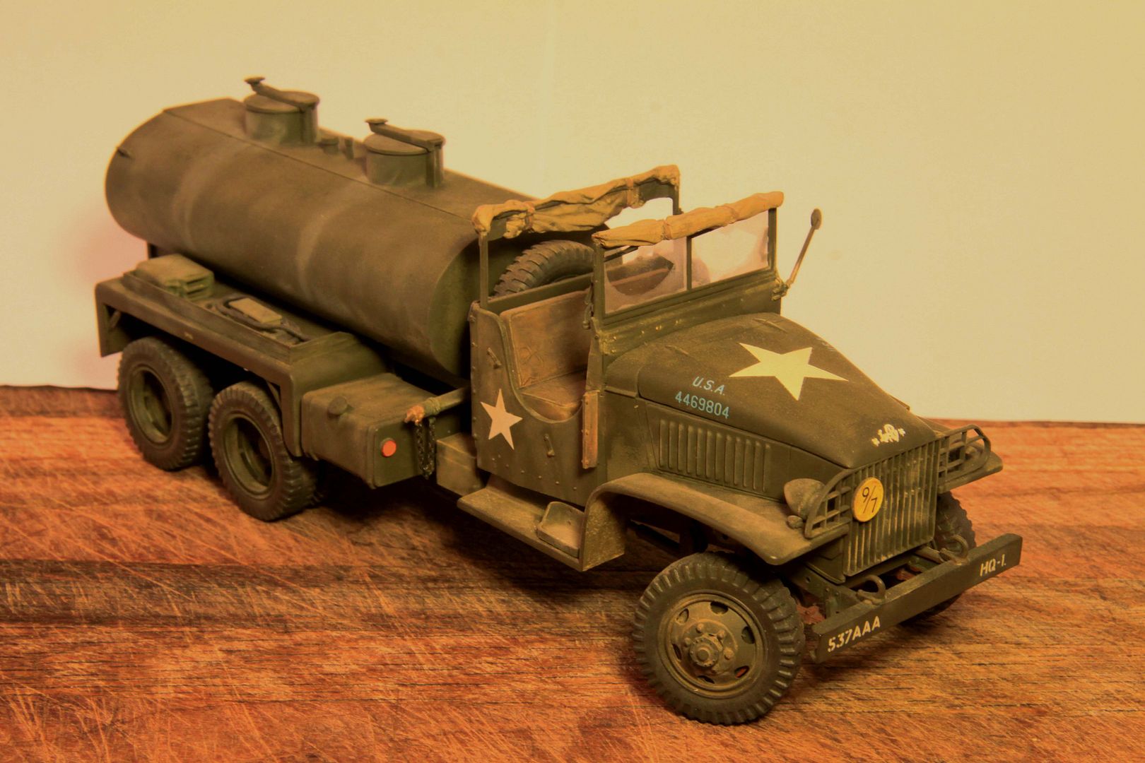

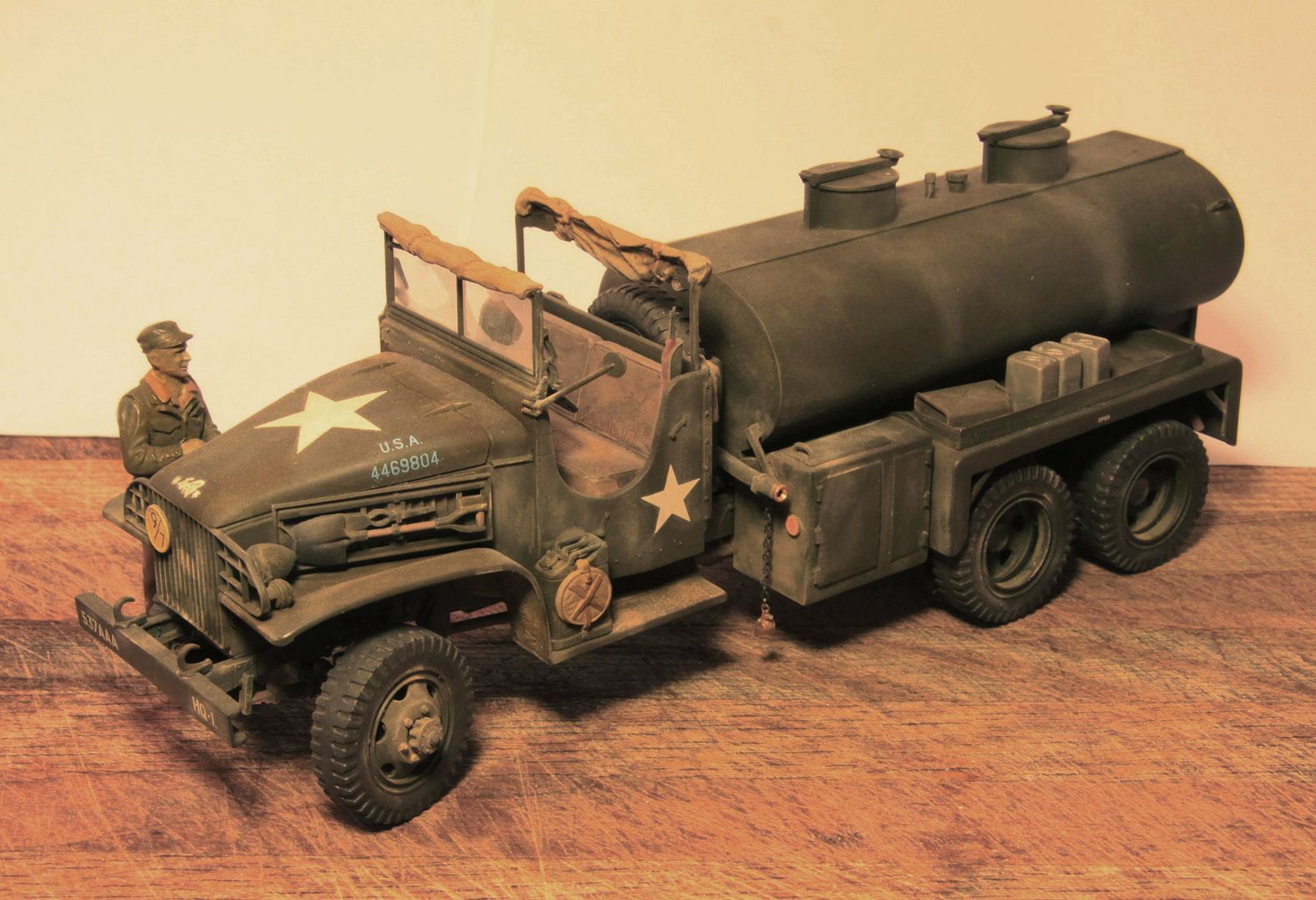

Work in progress tanker with substitute hard cab from Italeri water truck.
Model by John Hale
I remember John said he was extremely disappointed in the many Gas Cans included with the kit as being incorrectly proportioned. He recommended replacing them with an after market product as he has done here.

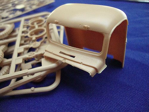

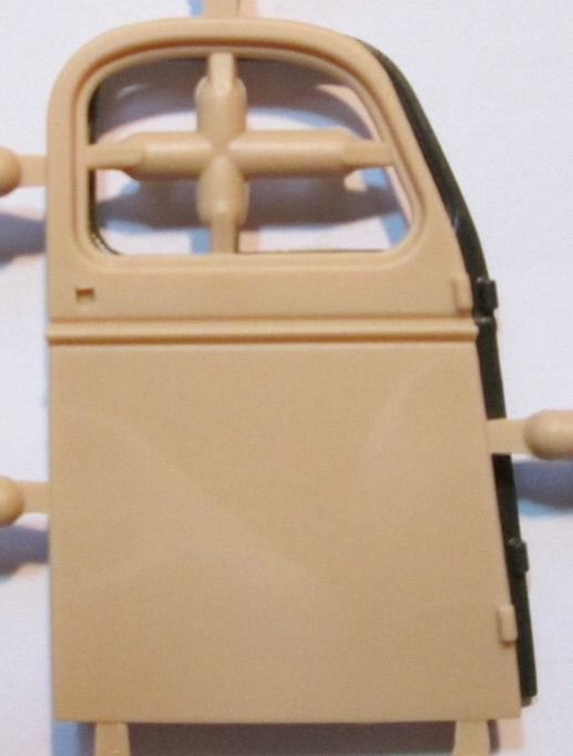

Just a quick note here:

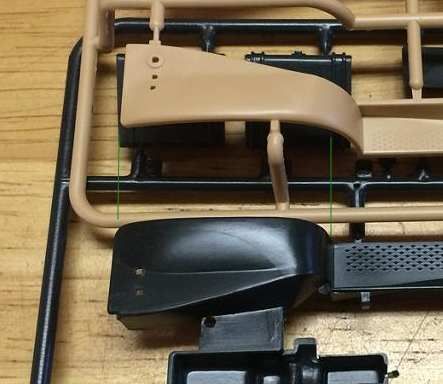

Everyone who knows me knows that where the Deuce cab is concerned I am a HobbyBoss hater. They made their fenders WAY too long for their first Bofers Deuce** offering and then had to squash the hard cab to make everything fit. Overall the front grill to cab back wall length is correct but the proportions in between are all wrong. Because of this, the overall HB cab length is correct, that is why other more correct manufacture's cabs can be easily substituted.
HB fender seen on top, Italeri fender below. This problem also makes the hood way too long. - John Hale Photo
HB cab door overlayed on top of Italeri door. Door is too short. - John Hale photo
Image of HB door photographically laid over actual Deuce photo. - My creation
HB pre-production photo. The minute I saw this I knew there were going to be problems. This looks like it would work perfectly for a Bedford cab but NOT for a US Deuce and a Half. - HobbyBoss photo
