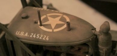

Here is the hood of a White 666 using the Future process:

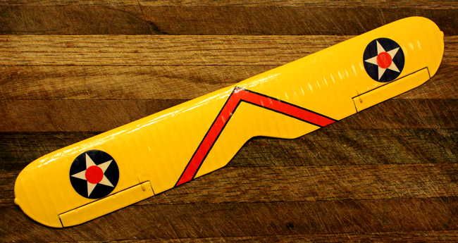

And an F3-F top wing with Future but ending up with a Gloss Clear topcoat:

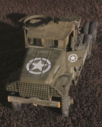

Home grown Mack NO using the Future plus Matte Clear (Tamiya TS-80) topcoat:

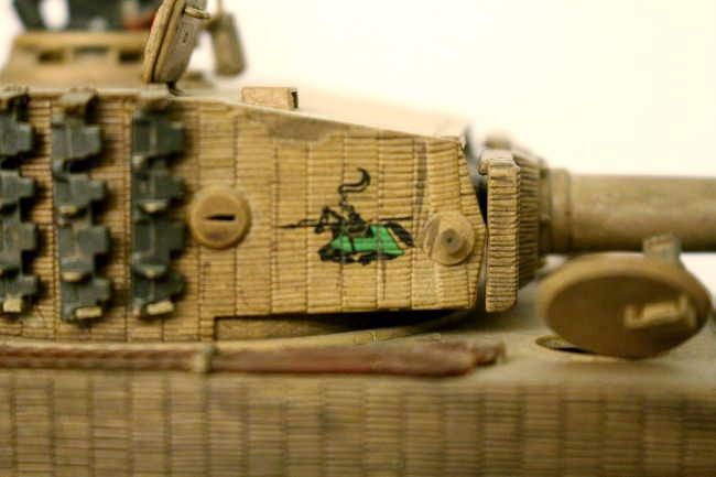

Tiger I with zimmerit. Jousting knight decal: Future + Decal + Future + Allow to Dry + Matte Spray + dark brown wash + pastels:
