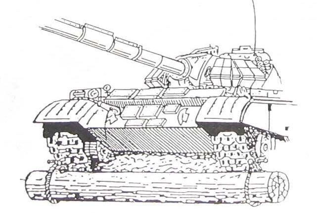

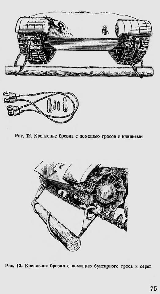

Why does the T-80 have a cylinder attached to rear of the turret?
Also why do Russian MBT's have a wooden log attached to the rear of the hull?

Hydar,
1: The log attached to the side/rear is an unditching log. Long story short, its chained to the tracks at the front and the tank drives forward over log helping to unstick the tank.
2: The tube on the T-80's turret (and some other Russian tanks) is a snorkel tube, allowing the tank to submerge while crossing water hazards.
