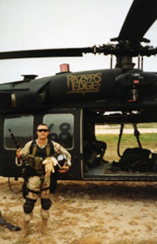

Super 68 'Razor's Edge' is now on display at the Army Aviation Museum on Ft Rucker, AL. It is in a more recent MH-60L DAP (Direct Action Penetrator) Gunship configuration though. She did not have the DAP parts and some of the sensors that this now shows during OGS.
More info on Super 68 "Razor's Edge"
Retired Air Force Master Sgt. and Pararescueman Scott Fales received U.S. Special Operations Commandís highest honor when he was awarded the 2012 Bull Simons Award in Tampa, Fla., May 23...
In August of 1993 Fales was assigned to Task Force Ranger in Mogadishu, Somalia. On the fateful day of Oct. 3, he led the search and rescue of ďSuper 61Ē a Black Hawk helicopter shot down by a rocket propelled grenade. Fales and fellow PJ, Tech. Sgt. Timothy Wilkinson, who would earn the Air Force Cross for actions at Mogadishu, were flying in ďSuper 68Ē toward the crash site.
...the helicopter they are fast roping from gets hit by an RPG while they are on the ropes ...
This is MSG Fales w/ Super 68 in the Mog.
A little more info on Super 68 from the Aviation Museum:
ďSuper 68 sustained significant damage in Mogadishu from small arms fire and a hit from a rocket propelled grenade...Ē
From CWO Gerry Izzo (pilot, Super 65):
"Super 68 was hit in the rotor blades by an RPG. This blew a semicircle out of the main rotor spar, but the blade held together long enough for them to finish putting in the medics and Rangers at the first crashsite. It was then that they headed to the airfield. What they did not know, was that their main transmission and engine oil cooler had been destroyed by the blast. As they headed to the airfield all 7 gallons of oil from the main rotor gearbox, and all 7 quarts from each engine was pouring out. They got the aircraft on the ground just as all oil pressures went to zero. They then shutdown, ran to the spare aircraft and took off to rejoin the battle. They were in the air just in time to affect the MEDEVAC of Super 62, which had landed at the seaport."

Super 68 was named 'Razors Edge' 90-26288, nose radar, FLIR, no hoist
- All helos had the numbers painted on the front cargo door of each a/c except 63.

90-26288 - "Super 68"/"Razor Edge"
