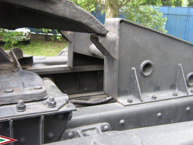

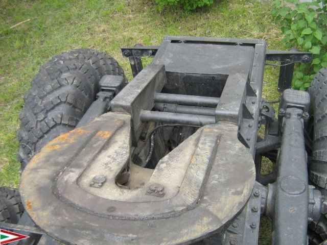

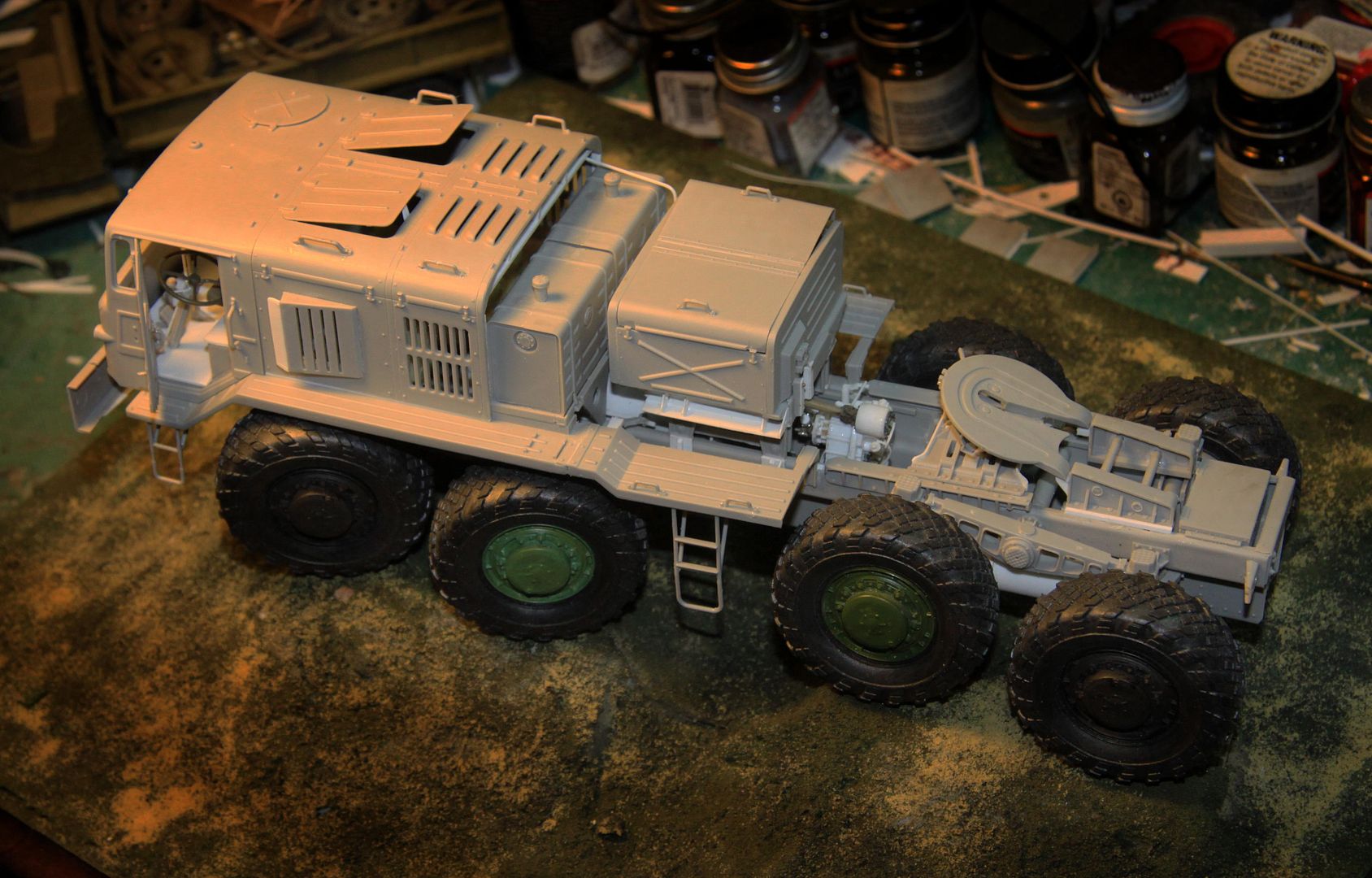

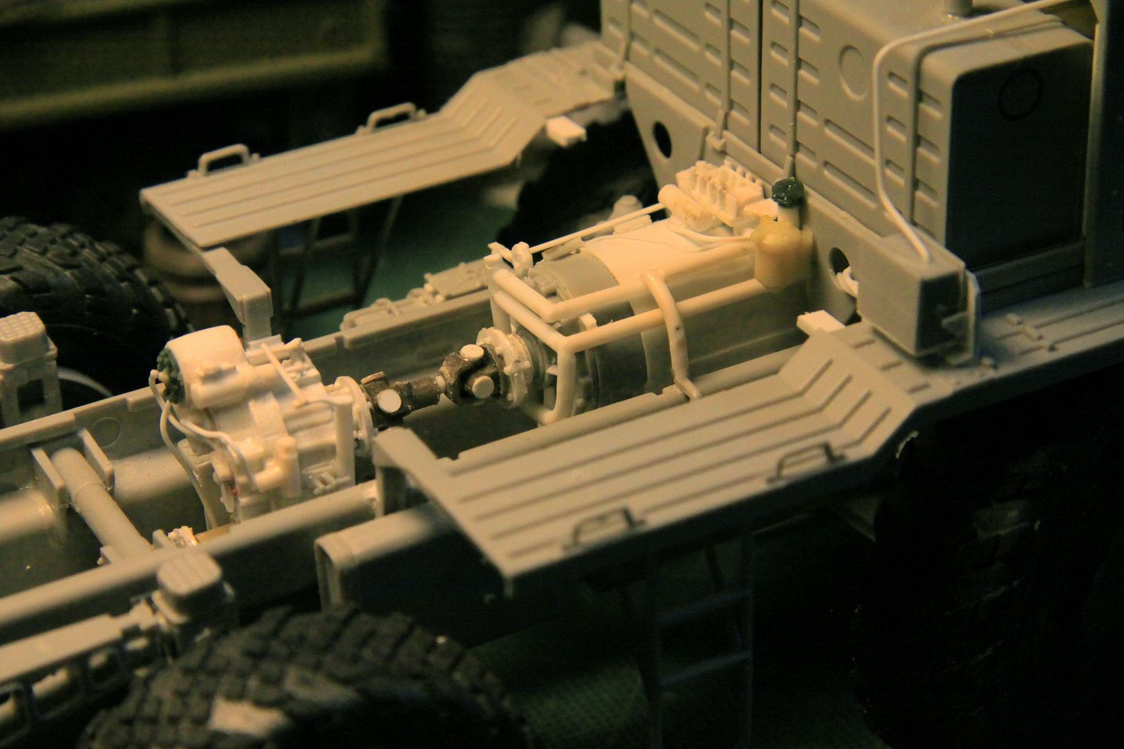

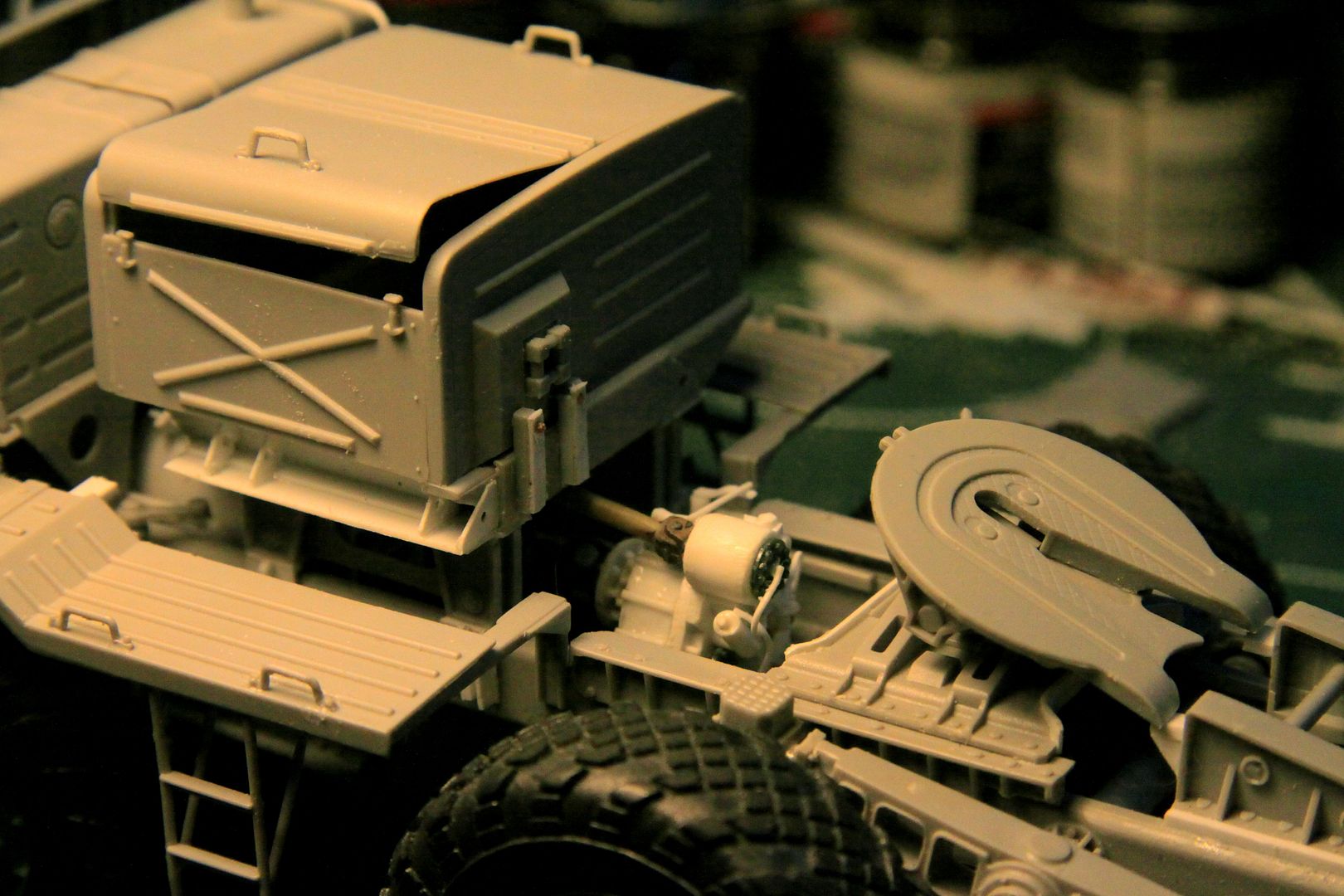

I also noted that the inclined trailer ramps in real life were spaced closer together than on the model. The ramps should align almost perfectly with the width of the legs on the fifth wheel.
It appears to me that the mounting flanges on these ramps are wider than on the model so that when the ramps are bolted onto the vehicle they extend further towards the centerline of the truck.
I therefore lengthened the right and left mounting flanges on the trailer ramps while shortening the two rods that bridge between the ramps.

Better photos:

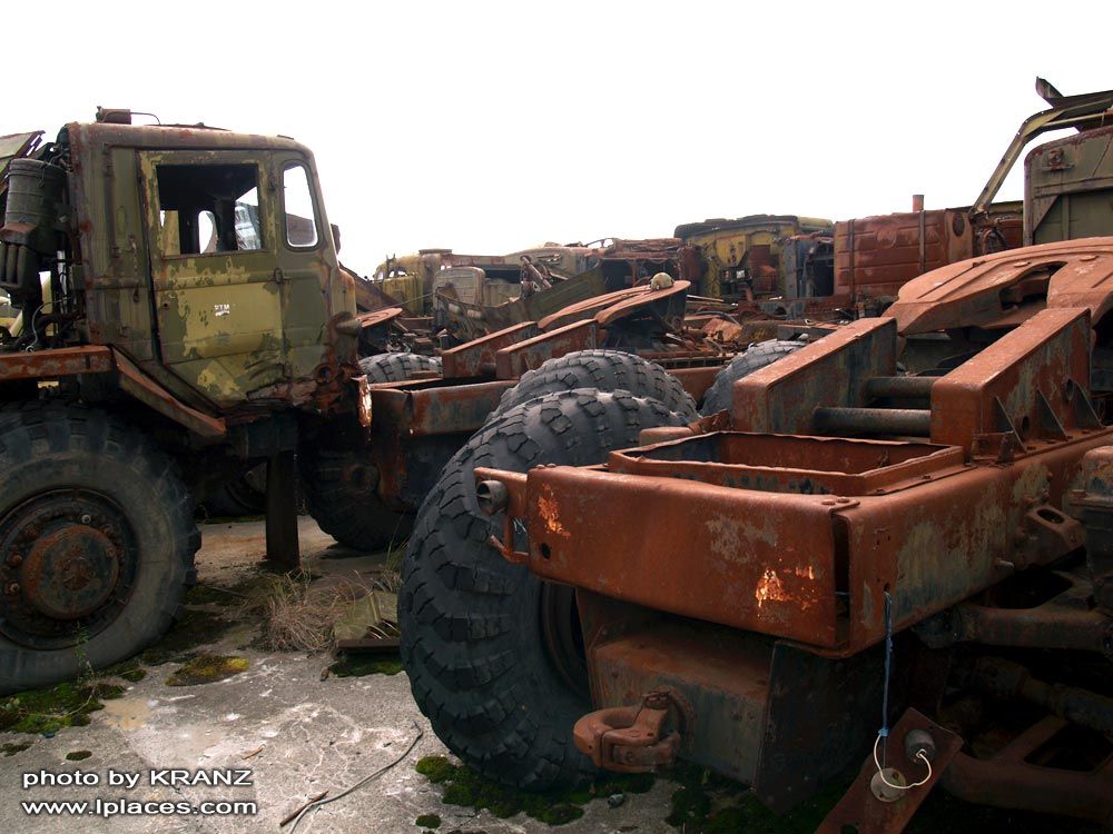

A sad scene but perhaps some detail references can come of it!
(Photo by Kranz)

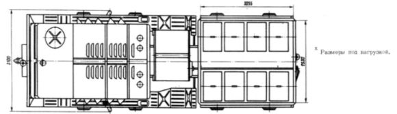

Again from 0Paperinik a PAPER model - scale unknown!

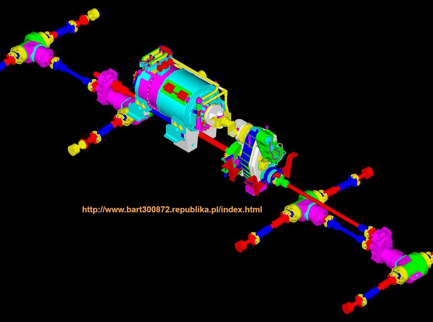

Touching again on the correct driveline for the MAZ-537:
I highly recommend this gentleman's website as he has done a fantastic job of rendering this vehicle.
http://www.bart300872.republika.pl/index.html

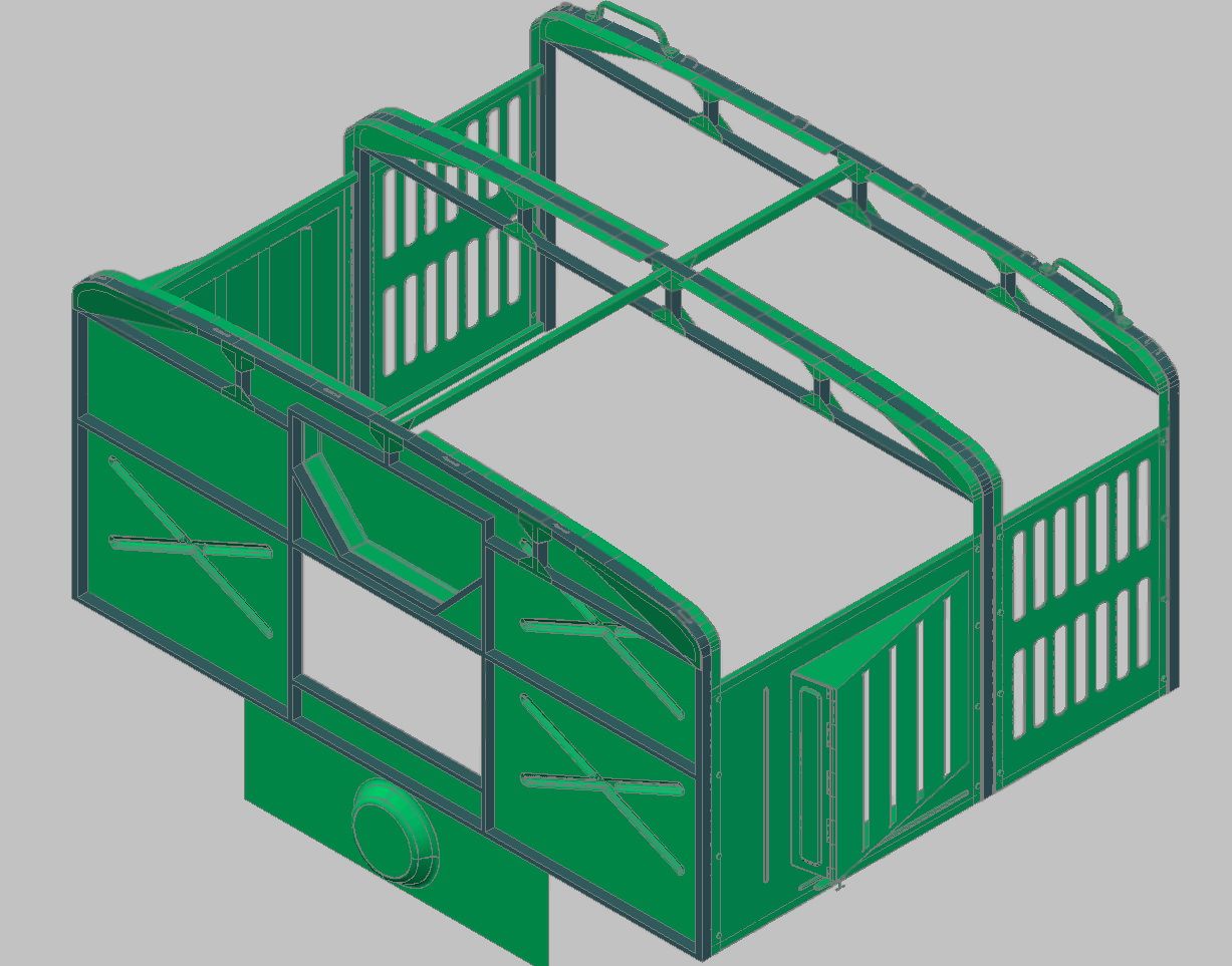

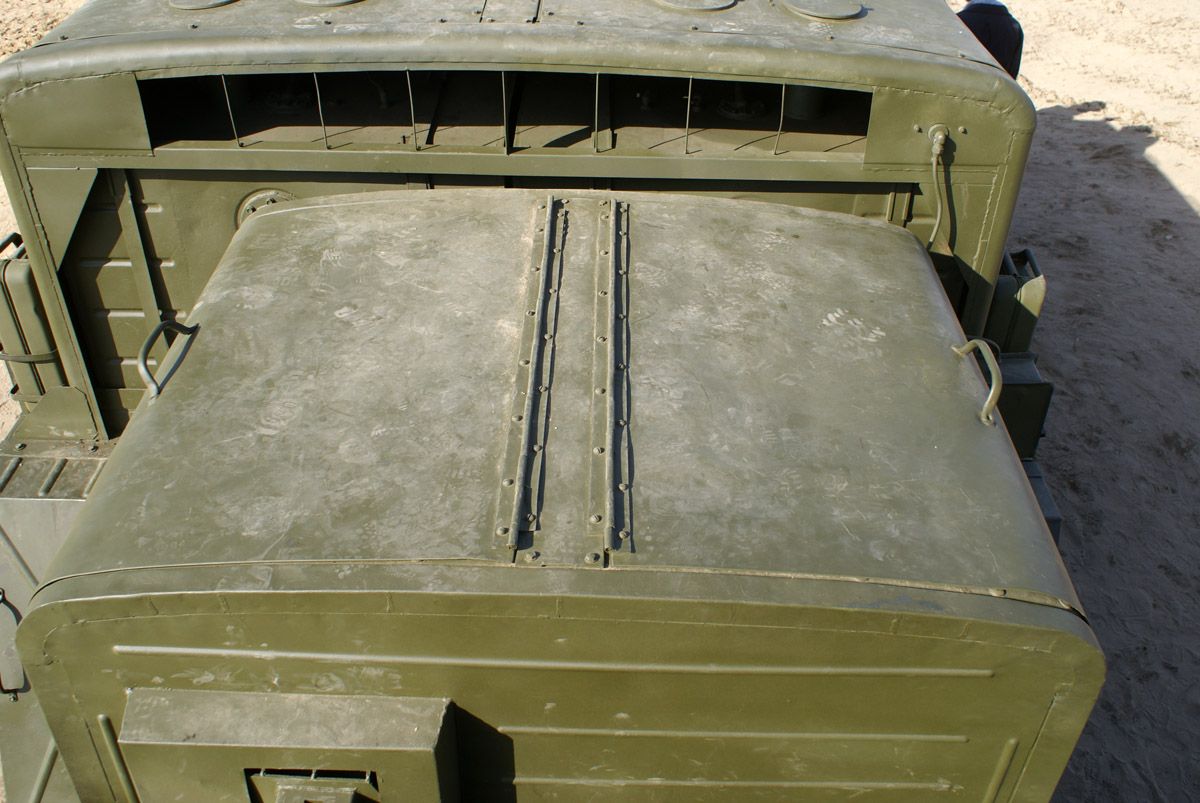

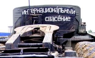

Sheet metal support structure from the firewall (just behind the cab) on back. This illustration shows the final production version that has no cover over the gas tanks.

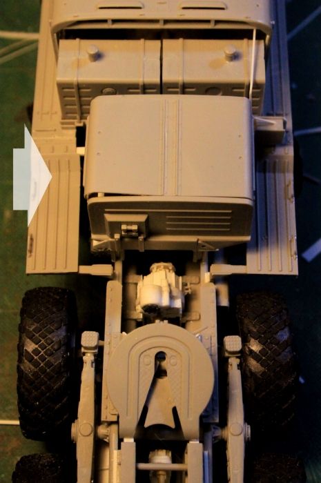

I am sorry, I don't mean to keep knocking a kit that has clearly had a lot of high quality molding effort put into it's production but I just keep finding glaring errors in this model.
Just this weekend I discovered (as have others) that the winch housing needs to be moved almost a HALF INCH off center towards the passenger side of the the vehicle.
The Trumpeter kit exactly centers the winch housing which is plain and simply WRONG!

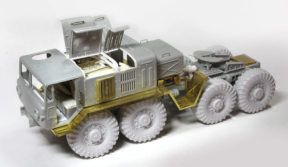

Beautiful execution by Florian Zehe:

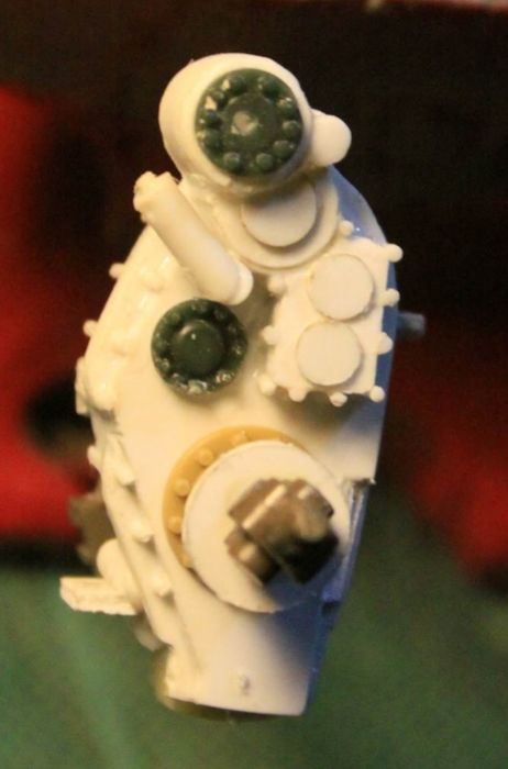

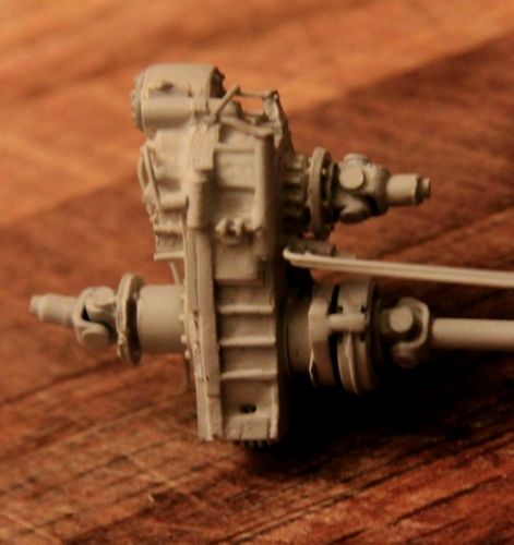

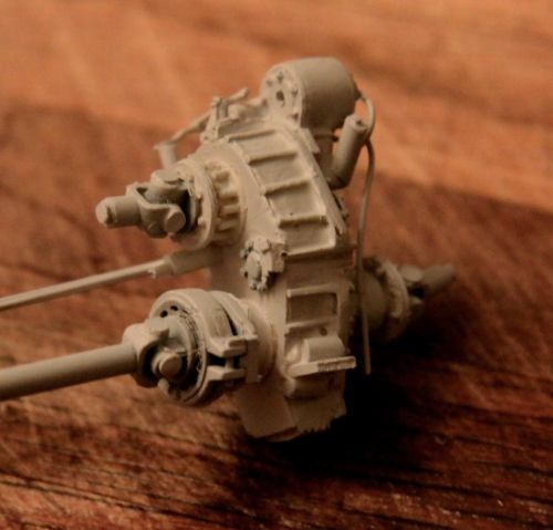

Moving forward with the construction of my transfer case and transmission for the MAZ-537:
Left front 3/4 view above
Rear view of transfer case

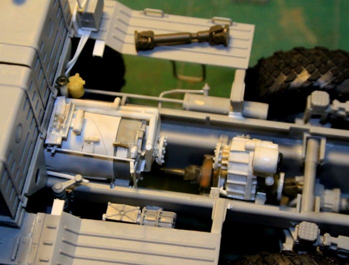

Top rear view of the new transmission and transfer case:
Last step is to add the driveshaft between the Transmission and the transfer case. That's it laying up on the fender at the top of the photo. Gotta get it over to Burtonsville Performance Engineering to have it shortened and balanced and we will be ready for a test run! ;-)D
While Burtonsville is working on the driveshaft I will be adding the lubricator lines and brake hoses.

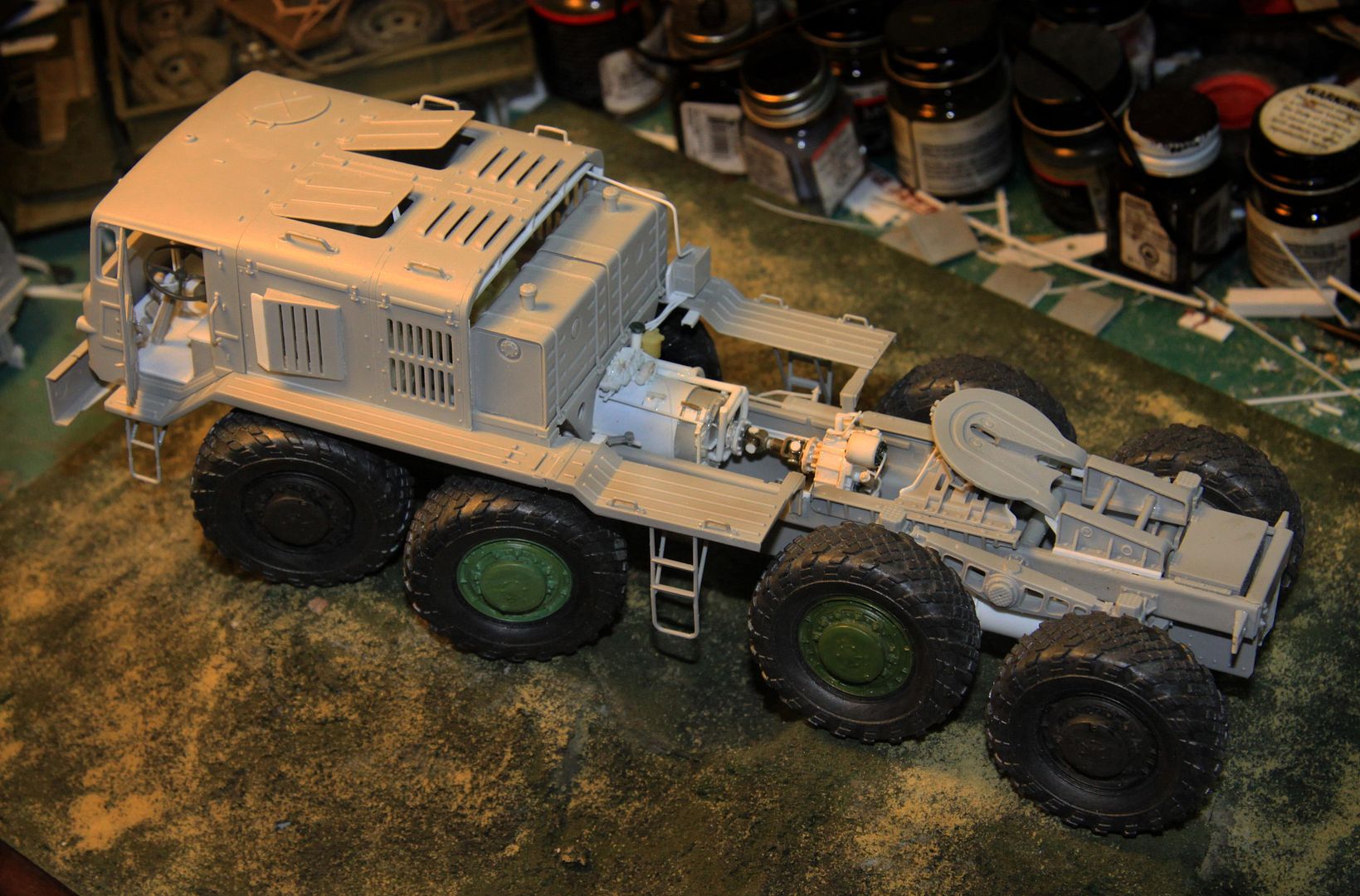

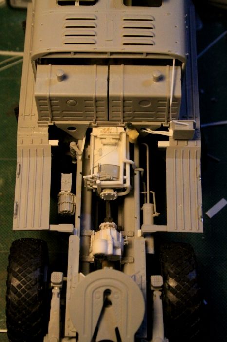

Proceeding with the rebuilding of the winch housing. Moving it off-center to the right and adding more detail.
Moving the winch housing is a subtle change but I think the asymmetrical aspect of this large feature gives a lot more visual interest to the vehicle.

Progress on the driveline:
#521
Kentucky,
United StatesMember Since: April 13, 2011
entire network: 9,465 Posts
KitMaker Network: 176 Posts
Posted: Thursday, April 24, 2014 - 03:59 PM UTC
and on the winch drive:
The winch housing will remain removable so I can pose the 537 with or without the winch.

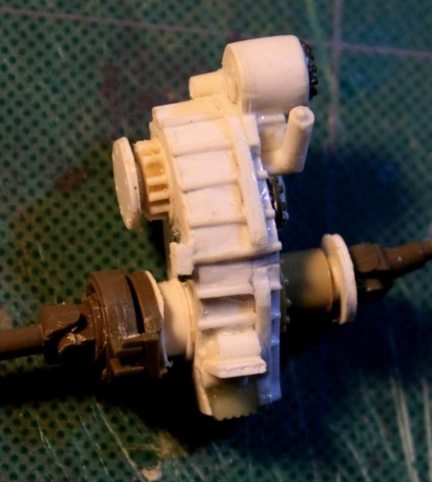

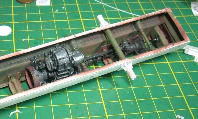

Finish detailing on the transfer case:
Center lines running to the right in the last photo are lube hoses.
