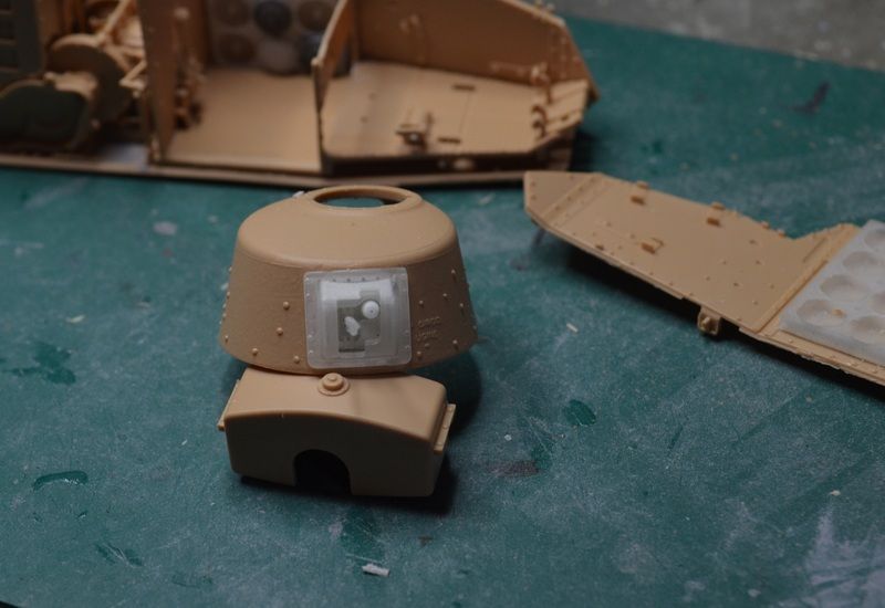

The next major grueling task was to replace the hinges on the back of the turret.
Rather large parts in a prominent area which therefore absolutely had to be redone.
I started by removing the hinges from the turret. If you work with PE-parts you always should remove plastic parts only if you have prepared the PE parts. Otherwise you are in trouble if you fail to construct complicated PE parts. I had all PE ready before cutting something away.
As I am not aware of some aftermarket PE for this kit I simply went trough the modeling garbage and collected some old PE sprues for a Panzer IV.
I removed these parts from the sprue, annealed them and pre-bended them.
Anealing the parts will help you to bend round or curve shapes.
I stole one of my girlfriends candles (got the vanilla one...
The next step was to bend the PE part around some sprue to make the hinge. I left around half a mm of sprue on each side. While holding the hinge with some tweezers I approached the excess sprue with a burning match slowly until the typical rounded bolthead often found on hinges formed from the melting plastic.
This way you get the typical look of a hinge. The whole thing is holding together without glue and is movable. This comes in very handy when fixing it to the turret.
Old vs. new.
The next step was to cut some spare PE and glue it next to the hinge wings to form a small "PE foundation". I then collected some PE parts from another kit and did cut them on the green line. This way I got 8 small plates with bolt detail.
I simply glued these on top of the PE foundation,applied some putty and cleaned the putty with a brush.
3 to go. The hinge will be cleaned and sanded another time after everyting has settled. Looks very coarse now but nice on the model. Still need to clean it up a little but I am happy with the result by now.

When Meng released their FT, I bought a couple as I reckoned that given the widespread use and the different versions, I'd be sure to find something interesting. First one I built as a 37mm-armed FT in German service in Normandy. A really nice kit that went together well and had a lot of nice detail. Enjoyed it enough to buy another.
When this campaign started it prompted me to do another, in fact two- one with the Reibel MG and another 37mm-armed version.
I thought I'd push the boat out a bit with both and add a few bits and pieces, including some of the new 3D printed parts from ETS35 (Niels Henkemans).
So here goes.I'm afraid neither my modelling skills nor my photography skills do the parts justice. They are truly amazing...
The Reibel MG in the kit is actually pretty good, but the new one takes it a bit further and is the right size:
You have to do a bit of trimming on the turret, getting rid of the raised surround and cutting back a bit but nothing painful. Here the new parts for the gun mount are just pushed into place- no glue as yet. Fit is perfect:
The kit's ammo racks for this version are a bit dissappointing- they're a bit clunky and they're full. The new parts again fit perfectly. They are extremely fragile (especially in my hands) which has dictated somewhat which spaces will have the drum magazines in them. The only thing I had to do to get a nice good fit was lower that part of the floor, then trim away the dot pattern where the racks meet the floor (ringed in red). Once this is done, everything fits fine:
