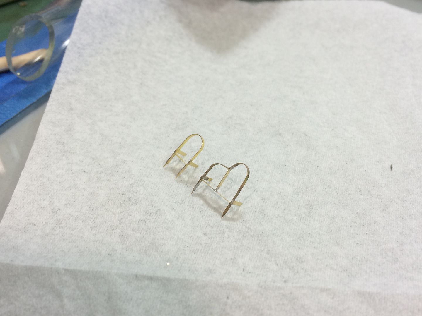

My PE set finally came in for the Stuart V. Here are the headlight guards which are the first assemblies I wanted to tackle. I prefer not to anneal parts as they become so soft, but the curves on the larger guard where not going to happen without it...

Paul- can I ask your annealing technique? I'm a newbie at that!

Posted: Thursday, September 08, 2016 - 09:18 AM UTC
Clayton,
You can anneal brass PE by putting it in the oven at about 480 deg F or 245 deg Celcius for 20-30 minutes if you are doing an entire sheet of parts. Toaster ovens are great for that. If you want to do on one part or a portion of one part, you can use the orange portion of a candle or other flame to do that. I heat the brass until the metal starts to darken and test the malleability at that point. I'm not talking about the darkening caused by soot from the candle, this is the metal itself. If needed, you can heat it until it turns red, but that is pretty hard on really thin brass parts. You can quench the parts in water if you like as it will not cause hardening in brass. If you are soldering, the brass will have to be cleaned again down to shiny metal as the oxides formed by annealing will prevent good solder joints.
Be aware, annealed brass parts are very susceptible to bending after install, so make sure you plan how you will handle the model after they are installed. That's why I Only anneal when I absolutely have to.
Hope this info is helpful to you...

Posted: Thursday, September 08, 2016 - 06:32 PM UTC
Excellent! Thanks for the info!

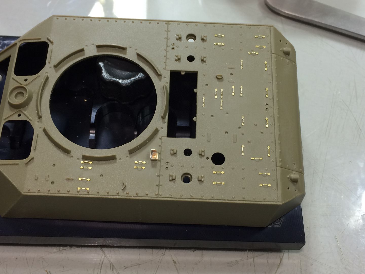

Made a little progress on the Stuart V. Finished putting the PE tie downs on the upper hull this evening. The Voyager set has some challenges as the tie downs aren't etched too evenly. Removing molded detail, bending the tie downs and installing them took about 4.5 hours, but they do look better than the molded on parts.
Paul, I have a set from Aber, I think, of these tie-downs. I've gone through 8-10 without a single one coming out correct (using on my M108). So...I went the resin route: bought a set from TMD.
Yours, on the other hand, look fantastic! 4.5 hours spent well.

Posted: Saturday, September 10, 2016 - 08:26 PM UTC
Thanks Mike! I really appreciate the pat on the back. The method shown in the instructions was a complete no go. Had to come up with a way that made sense to me. Sometimes I wonder if the PE companies actually have someone build the products. Of course it's probably just my lack of skill that causes most of my problems...
The 88 is looking great by the way!
