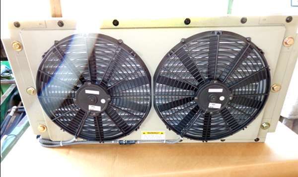

Gino, to your knowledge, does anyone offer that Red Dot Corporation add-on A/C system in 1/35th?

Posted: Saturday, November 05, 2016 - 10:11 PM UTC
OK, In the future I will refrain from freelancing and editorializing on designs I don't yet understand.
No excuse but the two wide open square A/C air outlets in the HEMTT blowing directly towards the windshield did not seem to make sense and made me think the unit had been installed improperly.
Fantastic reference photos you found there Gino.
Mike! You and Gino ARE AMAZING what with all your reference material and detailed builds!

Posted: Saturday, November 05, 2016 - 09:03 AM UTC
Nope, that is how it was designed to mount. It is a similar system to what was mounted in the first generation up-armored HMMWVs w/ASK.
It was the inside part of the below Red Dot system.
Gino:
Good find pic

Something of possible HEMTT interest: - Early add-on cab air conditioning unit.

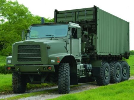

Michael, what you're actually seeing on that axle, is the tire being pulled in that direction. On all trucks/trailers that have multiple non-steer axles, they tires will be "drug"/"pulled" during a turn, especially while it has a load on it. Depending on which way the vehicle is turning/backing, you'll notice the non-steer axle/tires... I don't know how to word it.. Maybe offset?
You can see it here for example.
Sorry I'll have to post the picture when I have a better signal.

Gino I think I have to disagree with you on this one. On the photo in question wheel #3 looks parallel to #2 but off-set laterally from it.
The published Oshkosh sales literature definitely says axles #1, #3 & #4 steer.
One proposal that would explain both the steering and the photo: old steam locomotives used a trick to get around tight curves. The last drive axle did not steer but did move sideways in it's journal boxes to allow for some slight lateral movement and greater flexibility.
The entire number three axle assembly structure might move laterally (side to side) to allow it to more closely follow an overall curved line as the vehicle turns. It only needs to move to a small degree.
WRONG - A possible solution but incorrect for this vehicle!

The third axle looks in line w/the second one to me. I don't think it has been photo-shopped, just a weird angle. I don't see why the third axle would need to be turnable. The PLS only has the rear axle turnable and it is pretty much the same setup.
As to the Mk23 model axles, they are all the same as part of the TAK-4 suspension and all can be easily turned as there are stabilizer arms that attach to steering arms on the rear axles to keep them straight. Check out my build review of the Mk23 to see more. I address turning the front wheels there. The rear can be turned in the same way.

In this Oshkosh photograph the #1 and #4 axles are clearly steering. (The vehicle sales literature says the #3 axle also steers.)
I would say that there has been some photoshop work done here so nothing is for sure. Something does not look right with wheel #3. #3 looks straight, not turned and looks out of alignment with wheel #2.
