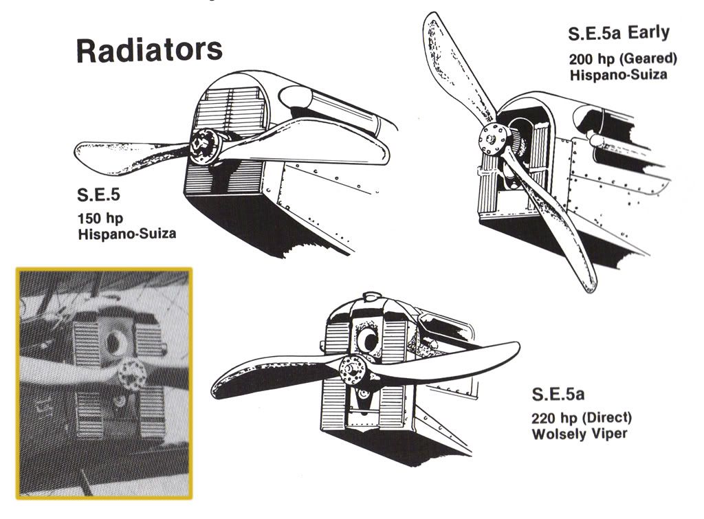

I've found this diagram, which gives a good primer for the different cowl/engines types:

Right, so I've found an image of the photograph Burden annotated and sent home to his wife, which can be viewed here:
http://memorial.flight.free.fr/Burden.html
Judging by the pitch of the prop blades, it looks to be that of the Wolseley Viper engine, but the rad/cowl is still that of the Hispano - anyone else see it like this?
edit:
Well comparing to the previous image I put up of the three engine cowls, the Burden photo comparison indicates it is a Hispano engine and prop. So Eduard has got the wrong prop blade (part B10), for the Wolseley build?

In the references I provided Alex Revell notes that some early Viper powered SE 5a types has the Hispano-Suiza style nose and radiator. He dedicates a chapter on that and the choices of propellers. The low thrust angle of the engine spindle for the prop notes that it is an ungeared Viper motor.

Hi Stephen, thanks - and yes,after searching/reading some more at the Aerodrome forum, that does seem to be the case.
Now did all Viper engines spin in one direction - believe it was stated they were all geared, but not sure in which direction that translates to for the prop pitch ...

I'll try to help.
The kit includes an example of the Woseley W.4 Viper return to the "direct drive" (not geared) and the thrust line is lowered back to a center the fuselage. Noted for its 220hp the Wolseley became the late war standard. See below.
Just a note here. The Wolseley Viper 200hp and the Hispano - Suiza 200hp motors were manufactured by two different companies. The Wolseley Viper was a bit of a quirk in that it took the design characteristics of the direct drive Hispano Suiza 150hp and improved them. The original contract had implied the more powerful geared 200hp Hisso but Wolseley was supplied the direct drive 150hp as a technical reference.
The Hispano Suiza 200hp was geared and had the high location for the prop hub.
