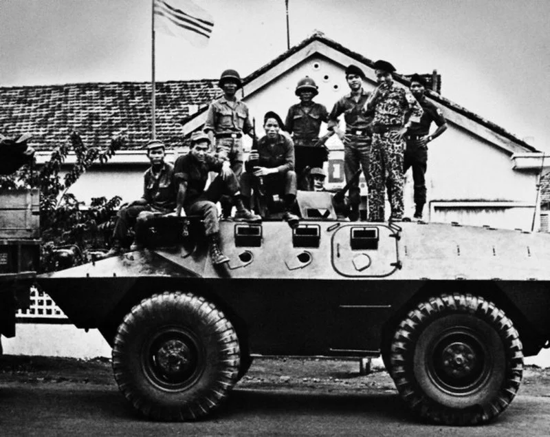

Didn't the ARVN get the old ones?
entire network: 12,590 Posts
KitMaker Network: 69 Posts
Posted: Saturday, June 22, 2019 - 01:45 AM UTC
I guess they got some :
Looks like angled corners on the wheel housings ...
I tweaked the lighting on the image above, probably ruined the rest of it ....
The original is here:
http://www.warwheels.net/V100ARVNhaugh.html
/ Robin
Posted: Saturday, June 22, 2019 - 01:47 AM UTC
...and 3 vision blocks per side
and that too
I was only looking for corners
/ Robin

More views :
Full size
Another ARVN one (fitted with "flush" vision blocks) :
