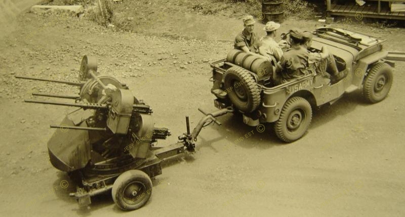

Have seen two M45 quads mounted on different trailers - one large M18 4-wheel trailer (see photos) and one embarrassingly small M20 2-wheel trailer.
M18 Trailer with Quad 50 turret
Victory Museum - Auburn, IN.
MVPA Convention - Dayton
Smaller M20 Trailer shown here.

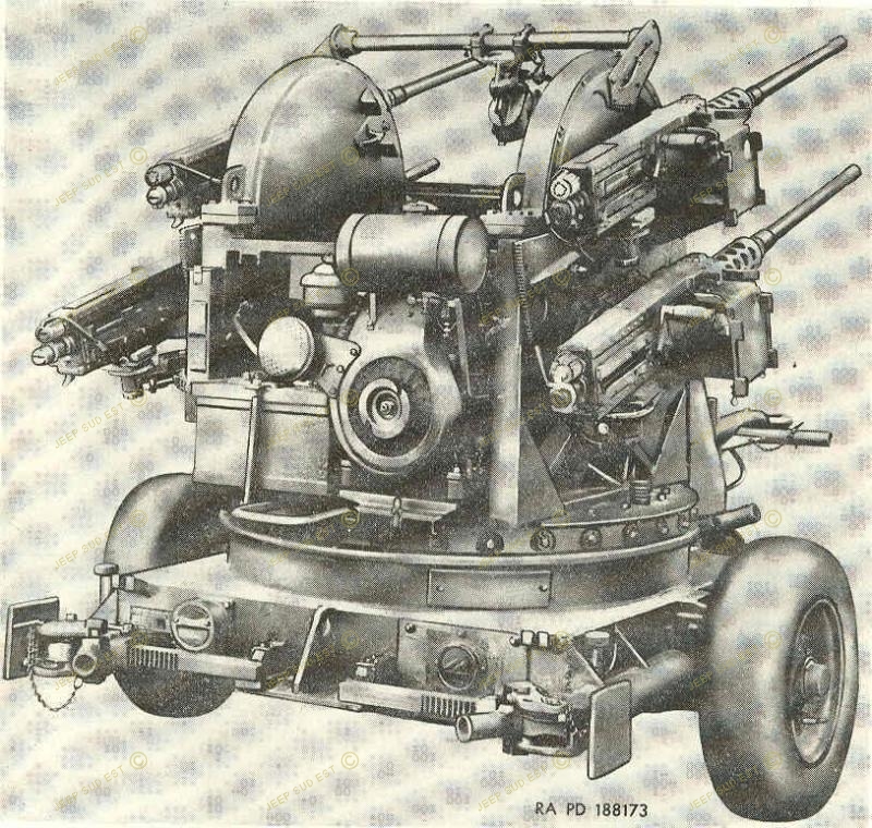

Talking about the Vietnam-era quad mount, it has some detail differences when compared to the WW2 one. Here's a Vietnam era Quad 50 :
(from David Doyle's Gun Trucks book review on IPMS USA website - good book BTW !)
You'll notice the generator engine is different, among other differences. The one included in AFV Club's kit is the WW2 model, like the one below...
(from David Doyle's Gun Trucks book review on rIPMS USA website - good book BTW !)
The quads I was around, used a remote generator with cables going to the gun carriage. Also the basic platform was larger, and maybe octagon shaped. The one we had in the truck was more like what we see in the picture, but no generator. Reason I remember this is when we recovered the quad off the truck; we had to come up with a power source.
