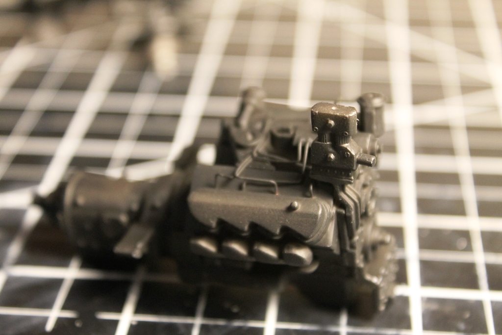

Posted: Friday, September 18, 2020 - 08:48 AM UTC

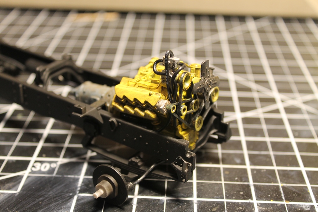

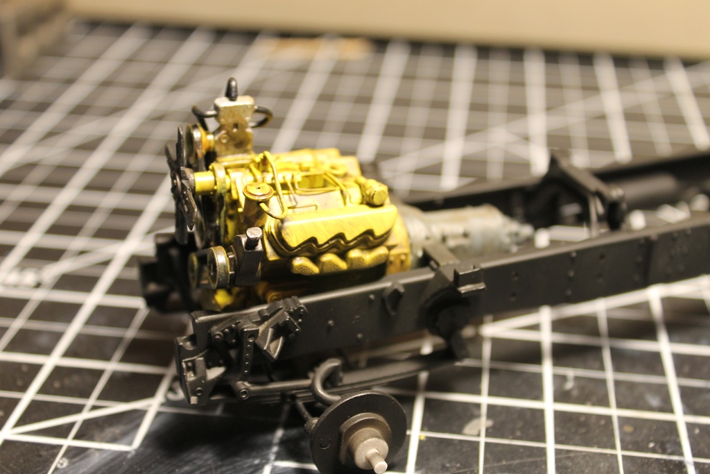

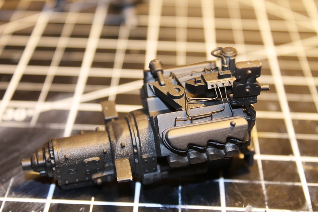

While still waffling on the main body color I managed to get the engine painted and weathered. The MM Bright Yellow over MSP 1500 Black looks just about right to me.
Engine is just mocked into the chassis as I still need to finish rusting the exhaust manifolds.
The rest of the parts, including the body, are in primer.

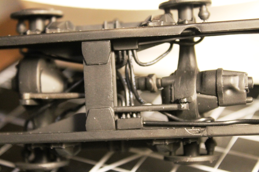

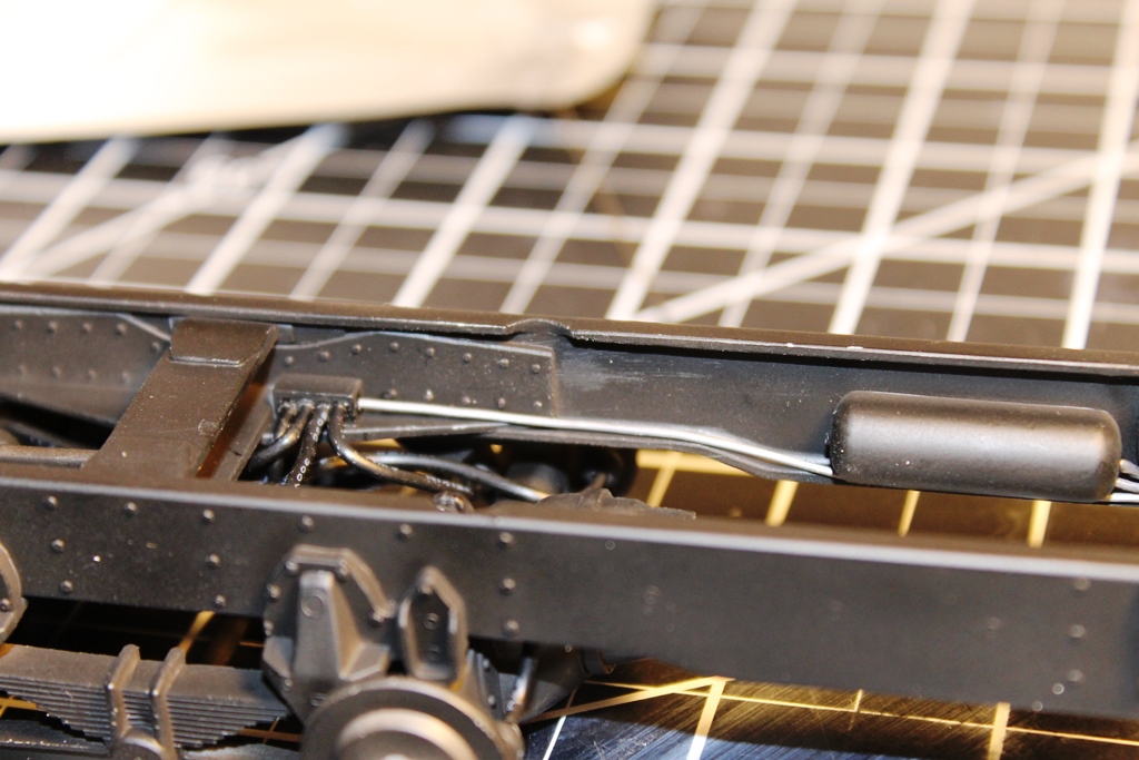

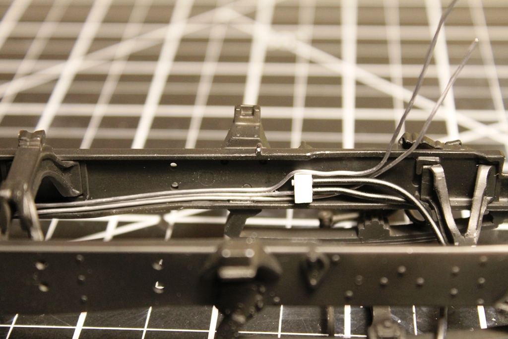

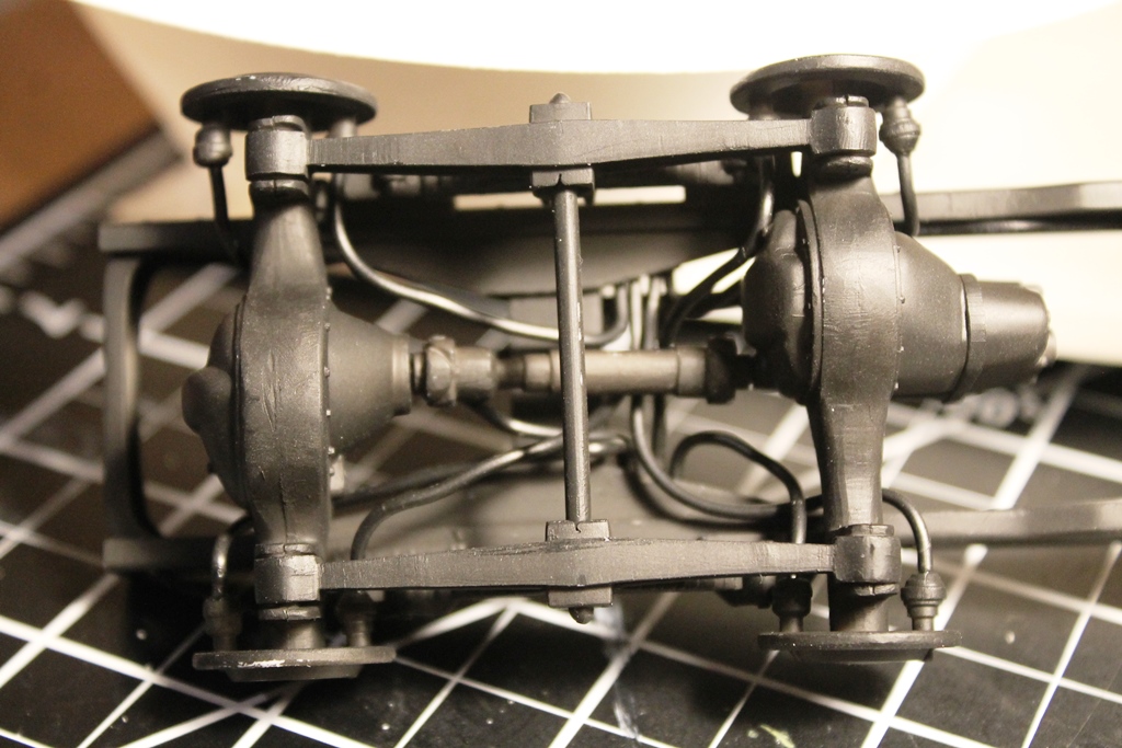

Had a long lunch today and spent some time in the basement doing some plumbing. The AMT supplied vinyl tubing is pretty hard to keep in the shape you want as is has no core. I used some solid core 24 gauge wire that had an overall outside diameter of .055"/1.4mm. Worked very well and kept the shape it was bent to. The other lines are .035"/.89mm solder to replicate the hard lines.
In this case, I used artistic license as the relay valves would be hidden by the fifth wheel plate and I just made up some manifolds instead to give them a place to go.
The rear service brakes are fed down one side through a tank into the manifold and then to the forward actuators. The parking brakes are the solder line feeding under the front brake air tank and onto the manifold then to the rear actuators. There is a solder feed line into the front brake tank and forward to the manifold then the wire lines to the front brake actuators. Sounds complicated, but it took less than an hour to plumb it all.

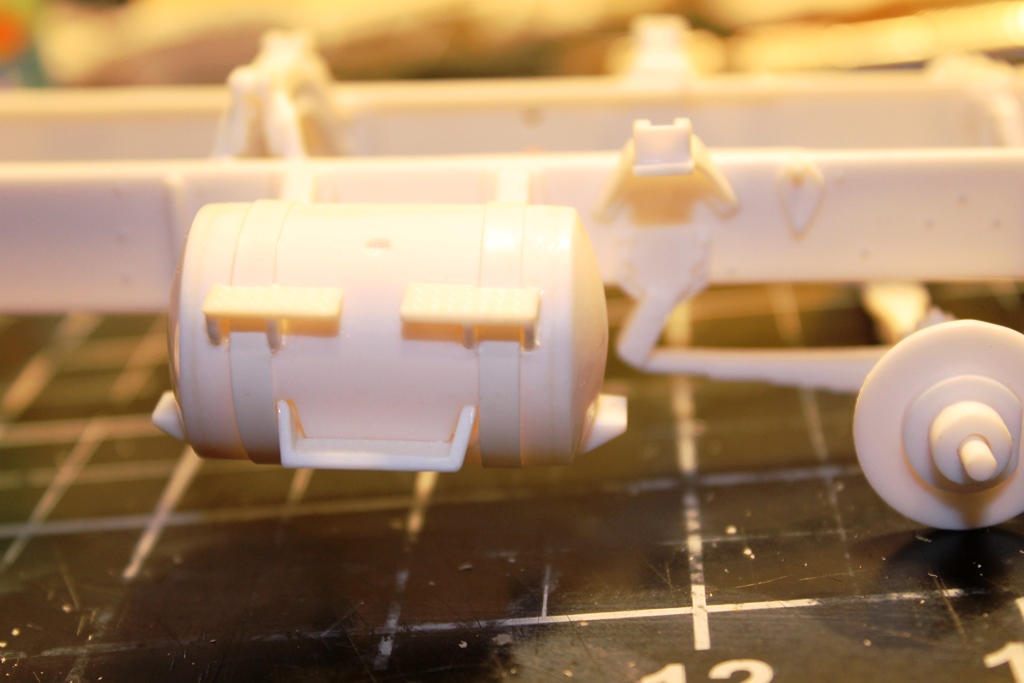

Posted: Wednesday, September 09, 2020 - 11:02 AM UTC

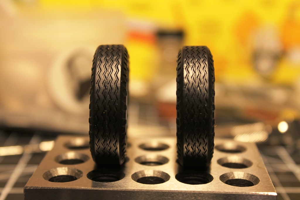

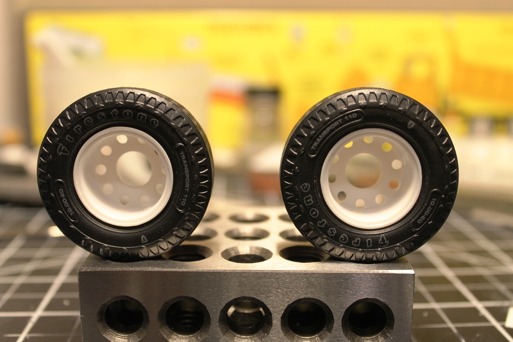

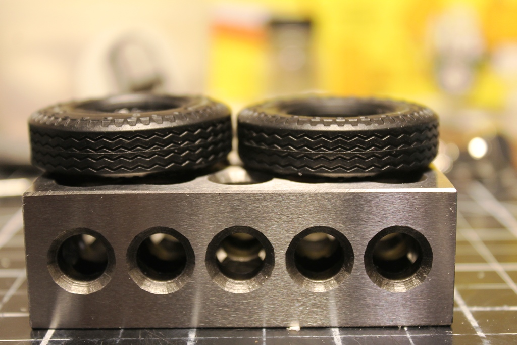

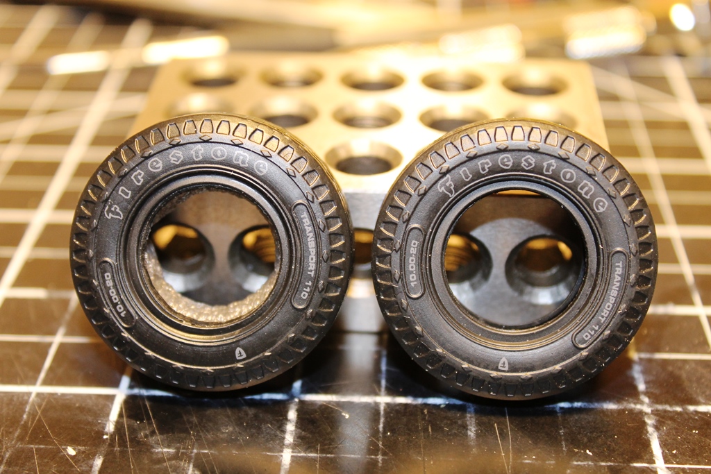

The tires/tyres in AMT kits used to be some of the worst to get aligned and keep aligned on the wheels, too narrow and to large of a diameter compared to the wheels.
Well, AMT fixed that issue, in this release at least. However, I still stuffed them with 3/8"/10mm backer rod which is a closed cell foam that is used to fill gaps behind caulking.
New tires with and and without the foam inside. I used a 3.5" long piece in each one. It gives a nice hefty appearance to the assemblies.
Some comparison shots with and without the foam insert.
Laser printed lettering on the tires.

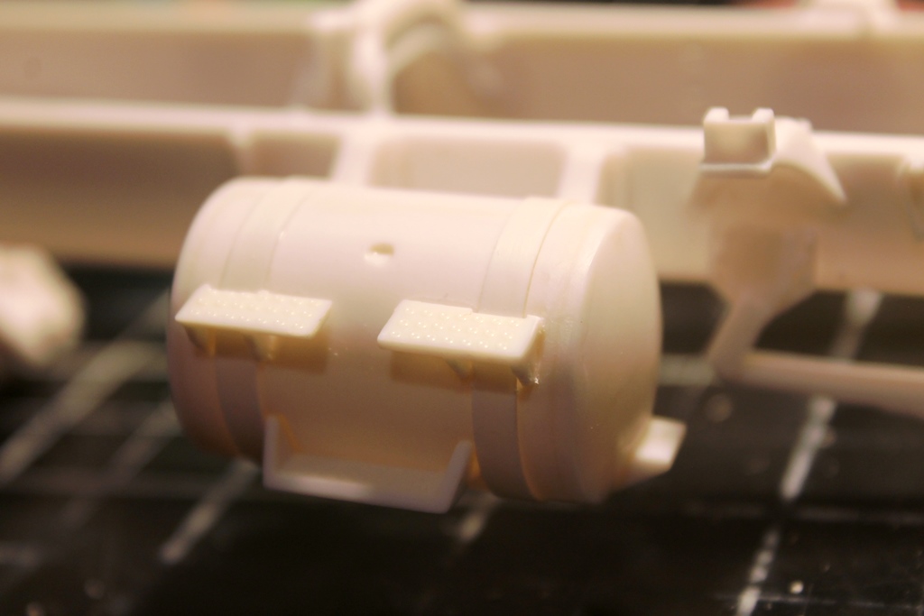

One of the fuel tanks finished and mocked into place.
A few more parts to clean still and then I hope to start laying primer before the end of the weekend. Black primer on the frame, white on the wheels and gray primer on the cab.
